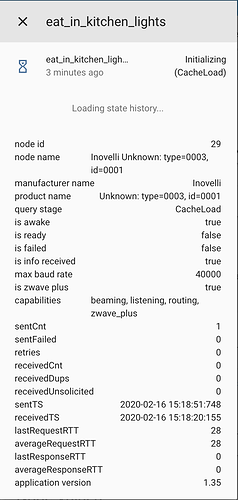

So I have 40 black series dimmers all around my house. In the old Inovelli switches and dimmers when I go into the info page I see all the neighbors the switch sees. The new black series dimmers doesn’t event have a neighbors line/section. Do I need to enable the repeater on each of the switches? Am I missing something?

the screenprint showing unknown type indicates that you havent installed the inovelli config files into home assistant so it is using the generic switch capabilities
It looks to me like this device still being initialized by your zwave controller (CacheLoad).
