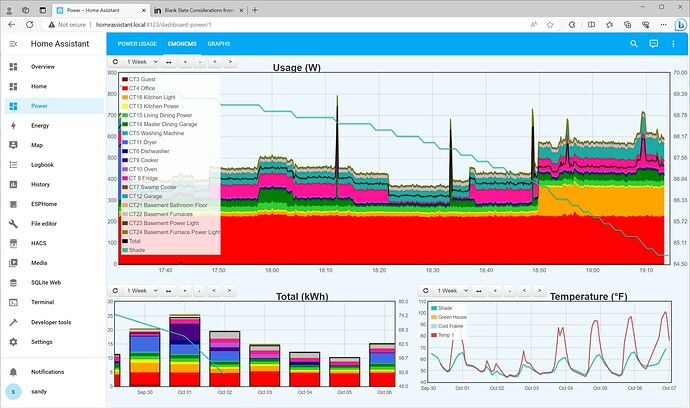

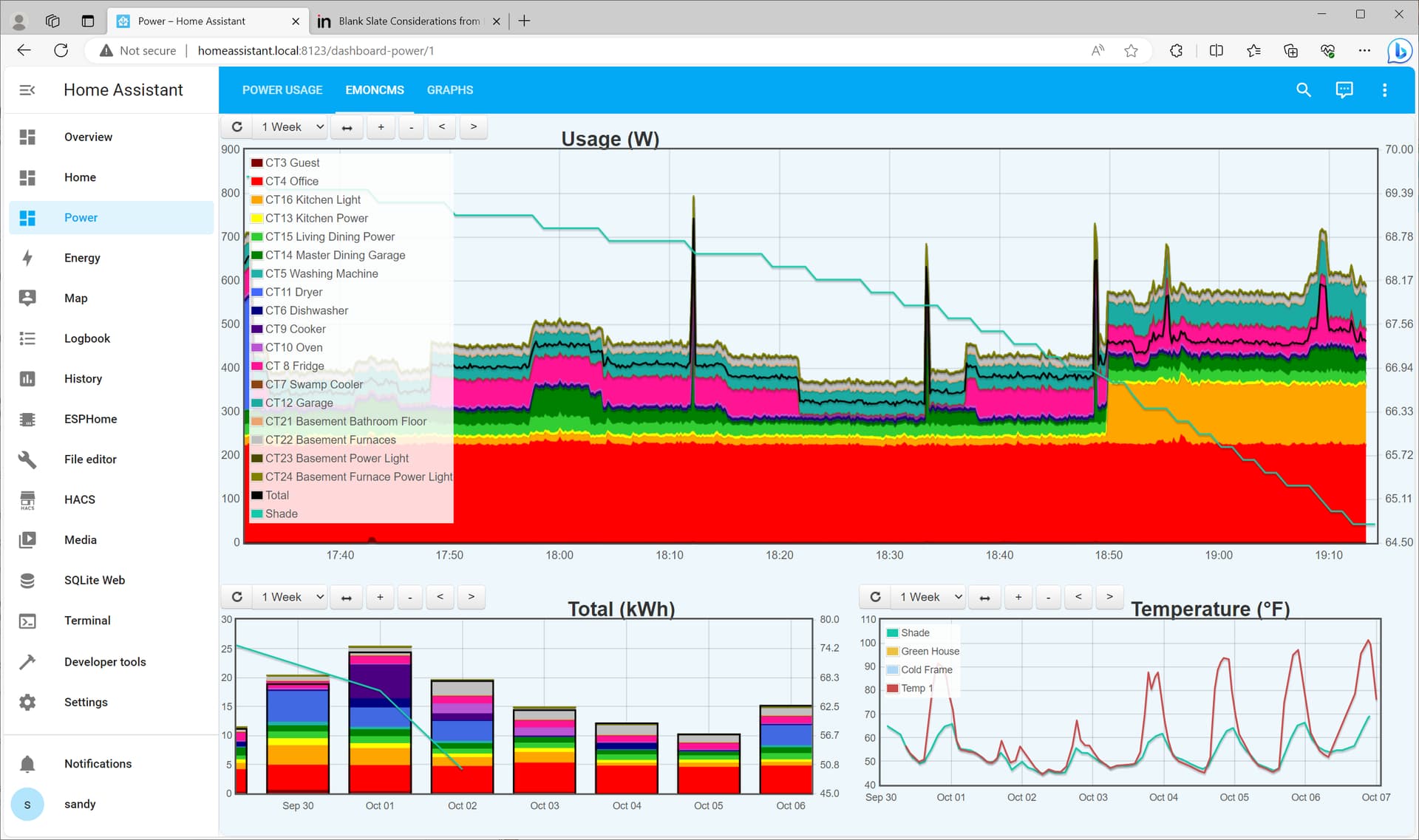

I’ve got a combination of EmonTx (www.openenergymonitor.org) an IotaWatt (www.iotawatt.com). Both reporting to a local EmonCMS. Then there’s an EmonCMS integration with HA… however, I’ve not been able to get the usage graphs I’d like out of HA - so I ended up embedding the ones from EmonCMS.
