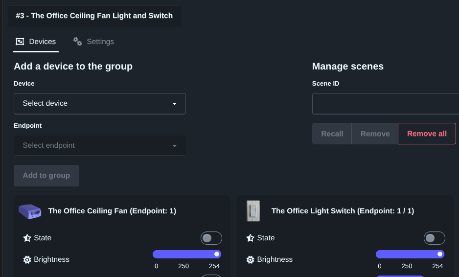

I use Zigbee2MQTT, not ZHA, so I don’t know how well this will map, but here’s what I do for the light to keep the states in sync.
Create a zigbee group that includes the light endpoints from the switch and canopy. In this case, “The Office Ceiling Fan Light and Switch”.
Then, in HA dashboards, automations, etc, address that group instead of the individual devices.

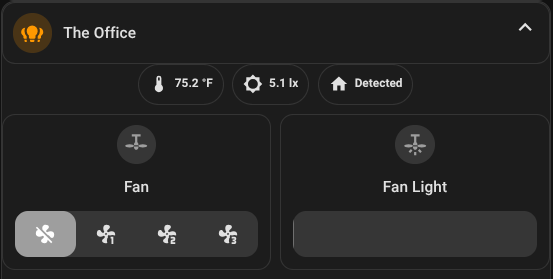

I’m not able to use the visual editor for that dashboard, but here’s the yaml for that section:
                      - type: horizontal-stack
                        cards:
                          - type: tile
                            entity: fan.the_office_ceiling_fan
                            vertical: true
                            tap_action:
                              action: toggle
                            hold_action:
                              action: more-info
                            hide_state: true
                            features:
                              - type: fan-speed
                          - type: tile
                            entity: light.the_office_ceiling_fan_light_and_switch
                            vertical: true
                            hide_state: true
                            tap_action:
                              action: toggle
                            hold_action:
                              action: more-info
                            features:
                              - type: light-brightness
As far as I know, there’s not a way to do a similar thing for fan state.
