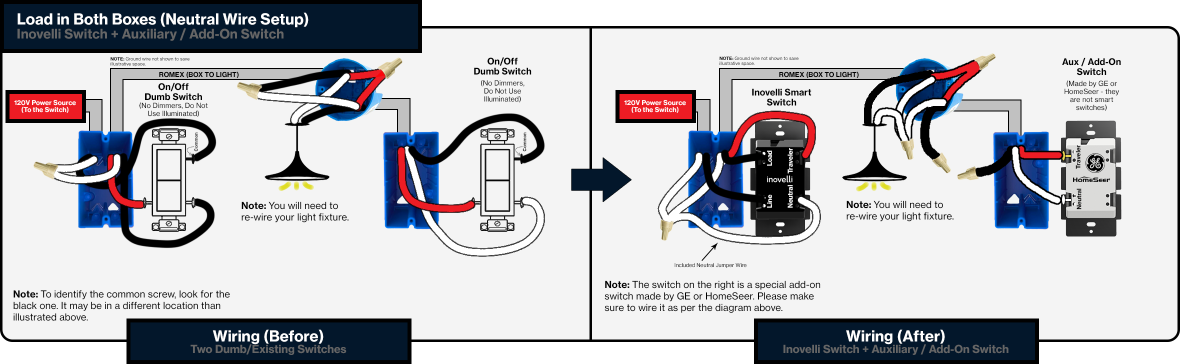

I think im wired like this. Think it would make a difference?
I actually have an aux switch but there are three ceiling lights that are running off the switch 12ft up in the air and I didnt feel like re-wiring them.

If you’re using a dumb switch, this would be the proper wiring.

No, I was asking if that wiring configuration might play any part in it. The switch is set to three way dumb switch with a neutral. I have tried resetting it multiple times and setting it to a dumb switch through Z2M as well with the switch itself. The behavior is the same with automations off.

It could, although your issue isn’t what is typically demonstrated with a wiring error.
