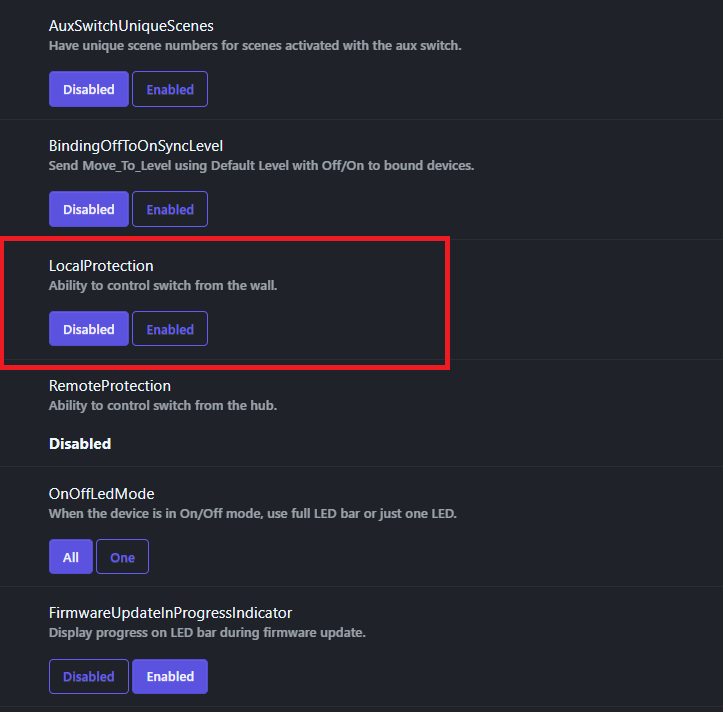

koadic is correct - disable Local Control (parameter 256), and set up hub automations to control ALL the desired lighting actions from the Blue.
I have one Blue set up this way - works fine as long as hub is running - that’s the big catch here. But LC can be re-enabled via the paddle if necessary.
