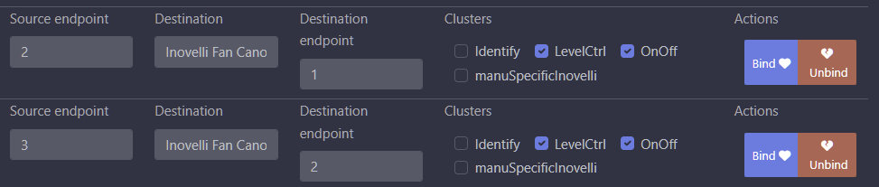

I am having a strange behavior with my blue fan canopy module. Currently it is bound to a 2-1 switch using Z2M.
For some reason, when I press the up paddle on the blue switch, the fan canopy will come to full brightness before dropping to the minimum. This happens about 1s after power is applied and is reflected in the home assistant interface showing a brightness of 0%.
I’ve had some lights behave poorly when ‘last brightness’ was selected so I have the fan canopy’s DefaultLevelRemote 1 parameter set to 242 and both the local and remote DefaultLevels of the blue switch set to 254. I’m not sure which is the controlling one here, but neither seems to be working.
Anyone else experience something similar or have recommendations for mediation?
