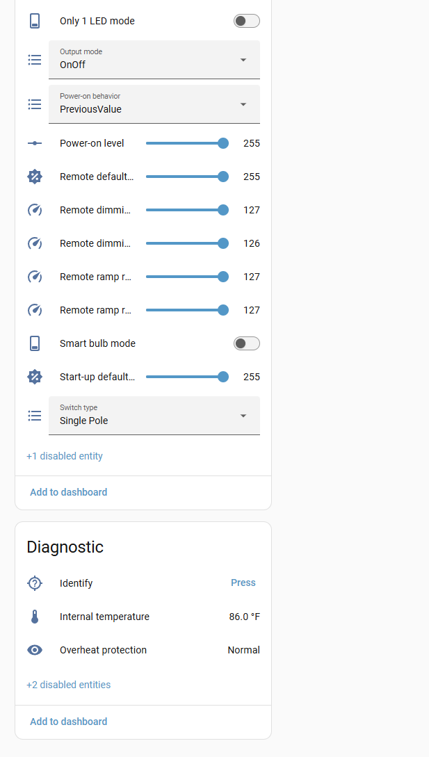

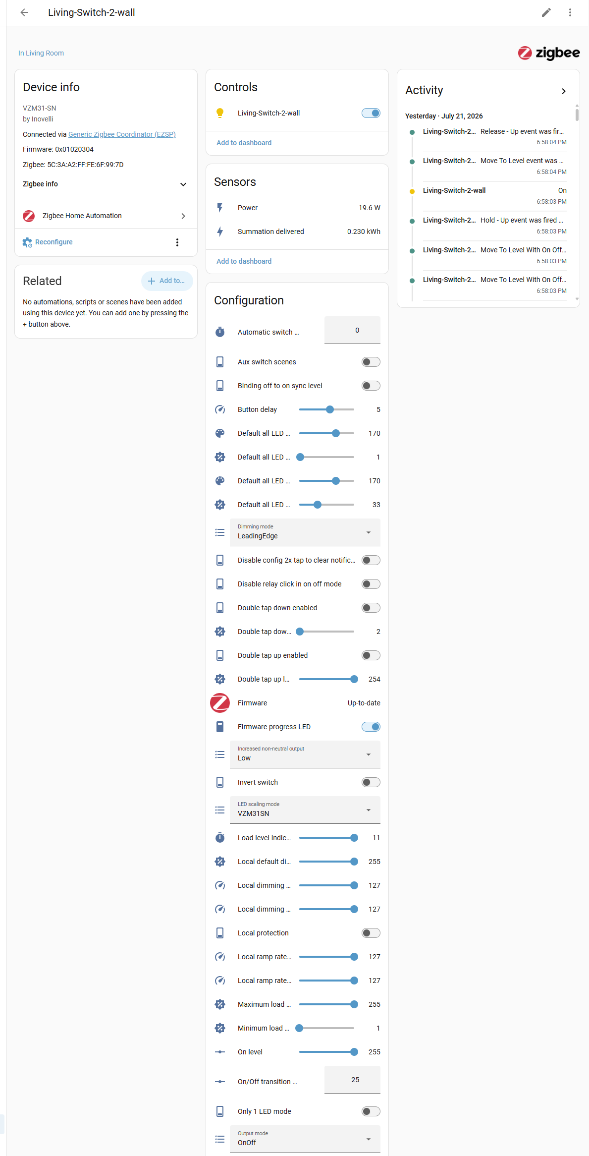

here are the HA settings
Thanks. As I posted above, the switch may be rebooting. Double-check for loose connections and for proper wiring.
