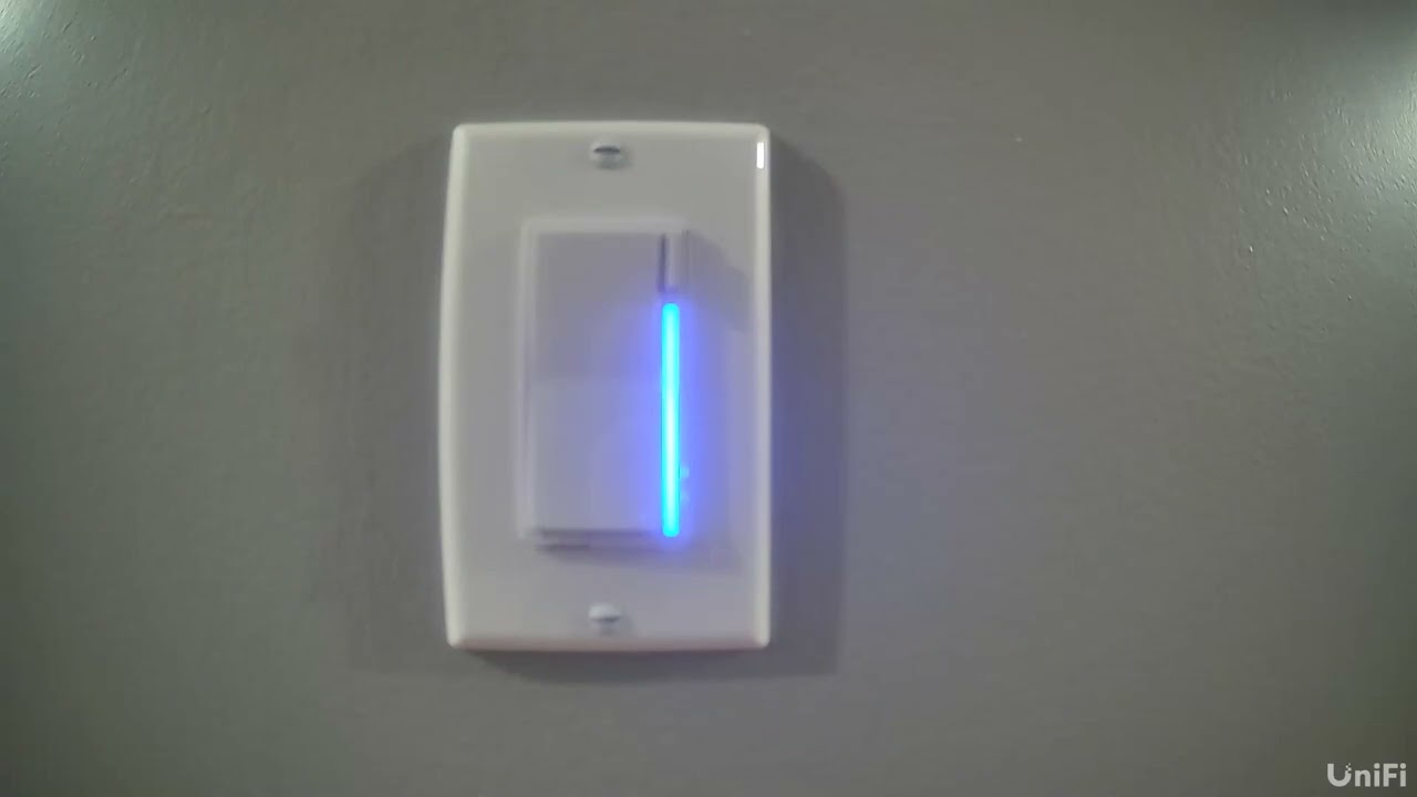

I setup a camera to record the whole update process. I exported from just before the update finished plus five min.
10 sec - OTA done and reboot
1:50 - LED flashes green like OTA is starting again
2:18 - Green flashes stop
2:22 - Switch reboot
It is currently 2 hours after the OTA process and the dev console is still reporting 2.11
