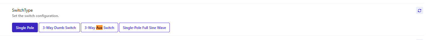

Can you provide more info on the load that is attached? I have tested non-neutral with 2x Philips Hue bulbs in Smart Bulb mode and I am not experiencing this. There isn’t a way to downgrade without using a USB flashing tool. I would suggest to attempt to factory reset the switch to make sure there is not any corrupt configuration data from the update.
Edit: Before doing the reset, can you try to change the mode to “Single Pole” to see if that makes a difference? If it is already set to Single Pole, change it to 3-Way Aux Switch and change it back to Single Pole.
Its 3 Philips smart bulbs in one fixture with a bypass.
I already tried switching to single pole from 3-way aux, it seemed to make no difference.
