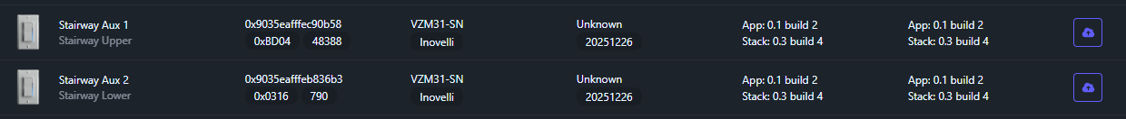

Seems to only be a cosmetic issue, but wanted to raise it. The version tag in Z2M says Unknown:
Or is this something I need to correct? - I tried restarting.
Thanks, z2m might just need some time to update that field. It is filled in for mine.
@EricM_Inovelli Can I make a suggestion for the Zigbee2MQTT firmware upgrade guide? The post-upgrade firmware version discrepancies can be resolved by re-interviewing the device, which can be done by clicking the “i” icon on the device’s page or device listing. This will query the device’s firmware version, among other things.
Its still not fully automatic, but at least you don’t need to navigate to the dev console and manually query each device, anymore.
