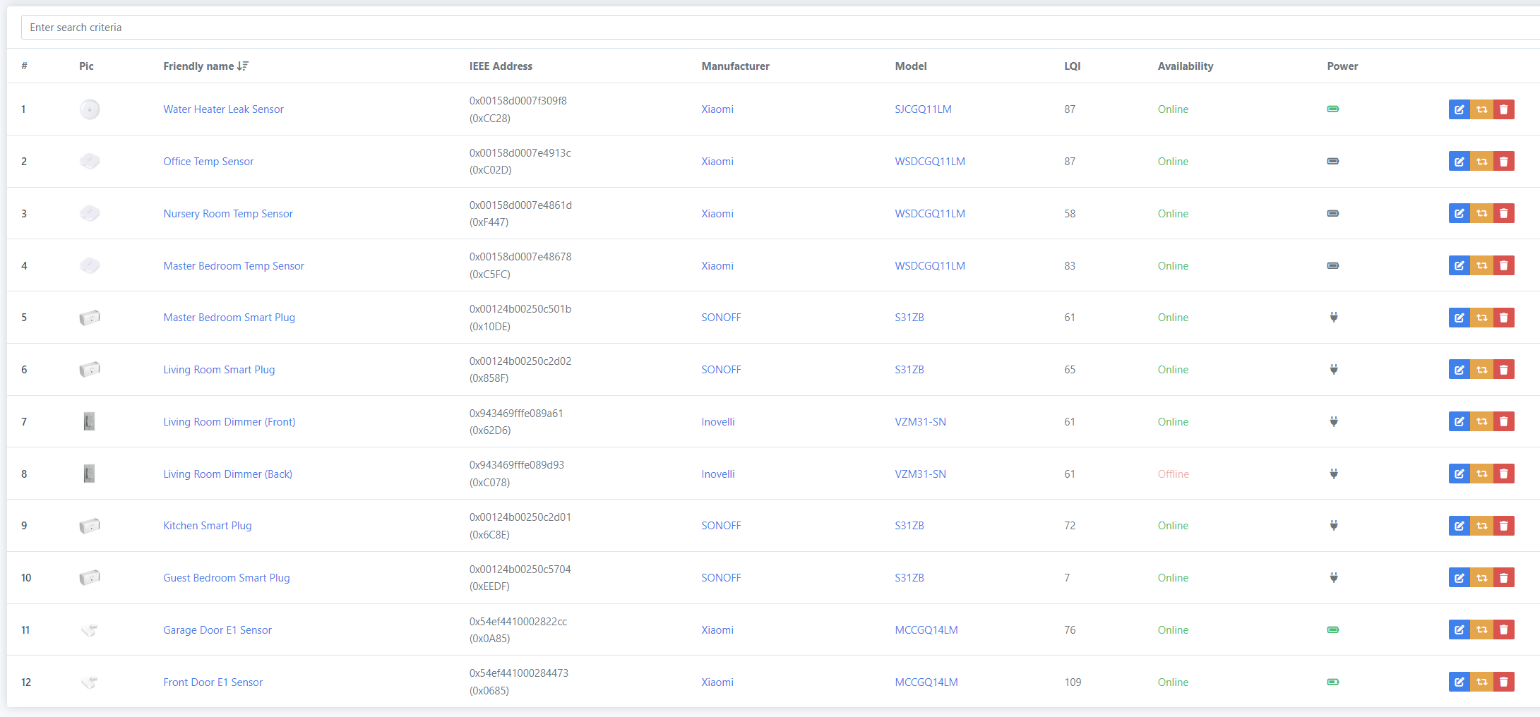

Twice now (in the last 48 hours), I’ve watched one of the two switches go “Offline,” even though it’s LQI has stayed in the ~60 range. When it first happened yesterday, I don’t recall doing anything, and it appeared back online about ~10 minutes later. Today, it happened again, but it’s been 20 minutes and it’s still showing offline.
Both are in the same room, and both have a similar view/distance to the closest router. Any thoughts?

As for number of zigbee devices, I have 12 (including my routers/extenders):
