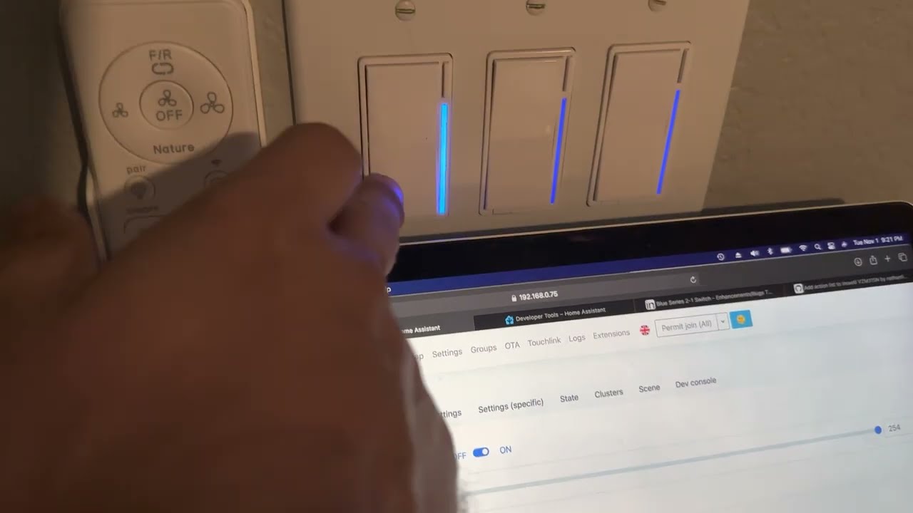

I’m not sure if this is a bug or if I have this configured wrong. I have set up three switches so far and they all do the same thing.
When using Non-Zigbee smart bulbs. Using both the built in Home Assistant Automations as well as Node Red, I set an automation to watch for a state change on the switch and turn the smart bulb on/off when it detects the switch turn “On” or “Off”.
However, Home Assistant isn’t registering the state change unless I go into Zigbee2MQTT and hit refresh (which defeats the purpose of the automation.)

I am able to get around this by having the automation watch for an action of “up_single” or “down_single” for the on and off commands, but it seems odd the state doesn’t change.

Use the single press scenes. It will immediately start turning on/off the bulbs. Otherwise it will wait until it’s “off” after ramping down before it’ll start ramping down the bulbs.
I agree the on/off state should be updated. Worked for me in ZHA well, so not sure what’s up with Z2M.
