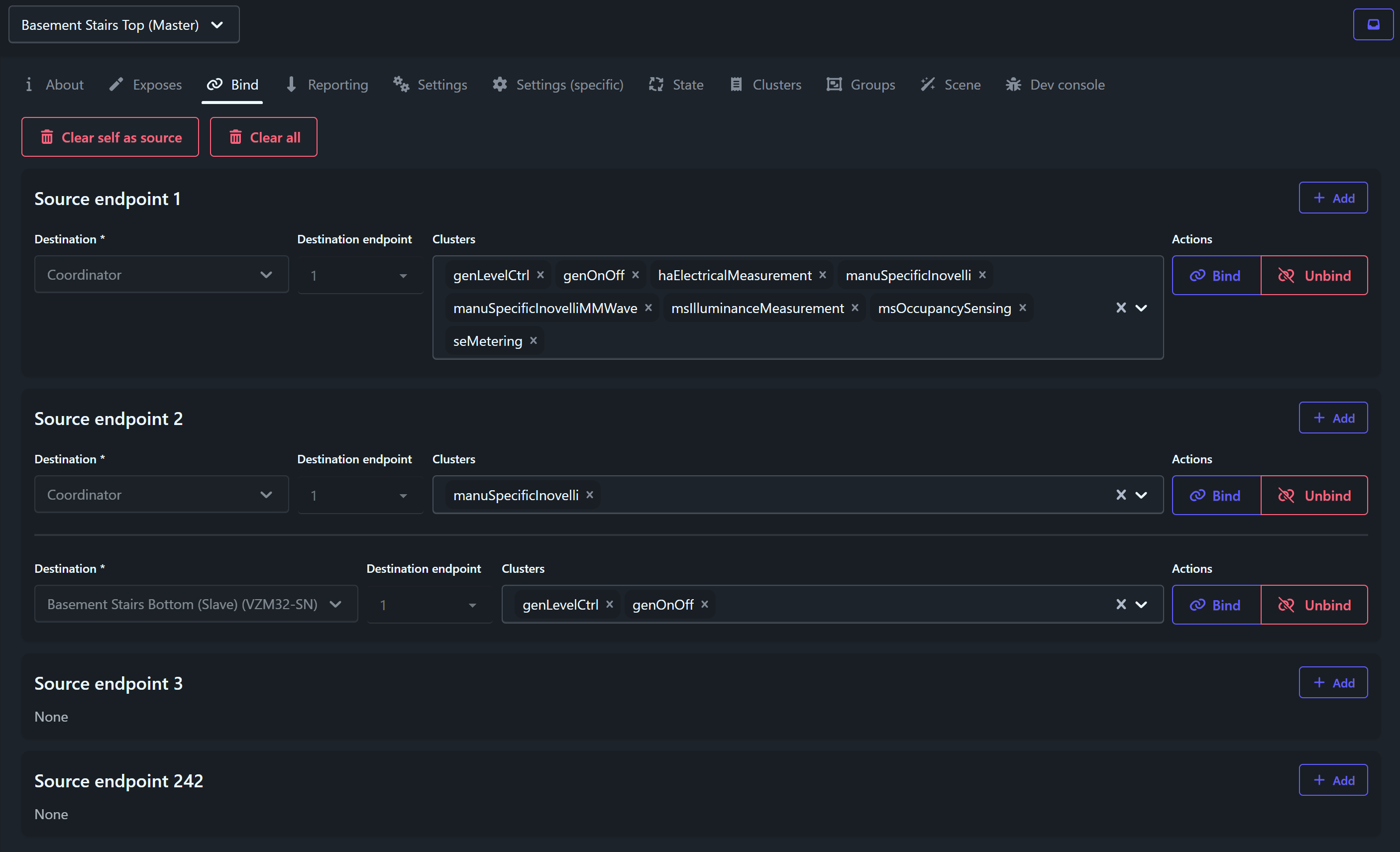

To clarify a bit: The issue seems to be that despite creating Zigbee bindings as described in the linked documentation, and verifying that the bindings seem to work correctly even when the coordinator is offline, sometimes the bindings seem to stop working. The best guess for cause is that there have been a few power outages recently (often short ones, or just flickers, due to weather) and it seems like the problem happens after power loss. When the problem state occurs, the switches that are bound together do not behave as if they are bound until their states are toggled a few times after which they eventually seem to sync back up. The issue doesn’t appear to be time based, they don’t automatically “fix” themselves if you wait long enough, they remain broken until someone manually pushes the buttons a few times.
It’s unclear what the actual underlying issue is, or why toggling the switches a few times seems to “fix” it. There are half a dozen or more pairs of switches that are all having the same problem.

The bindings we did were individual.

Each of these virtual 3-ways have bindings like the following:
As noted, this seems to work correctly most of the time and even works when the coordinator is unplugged as expected.

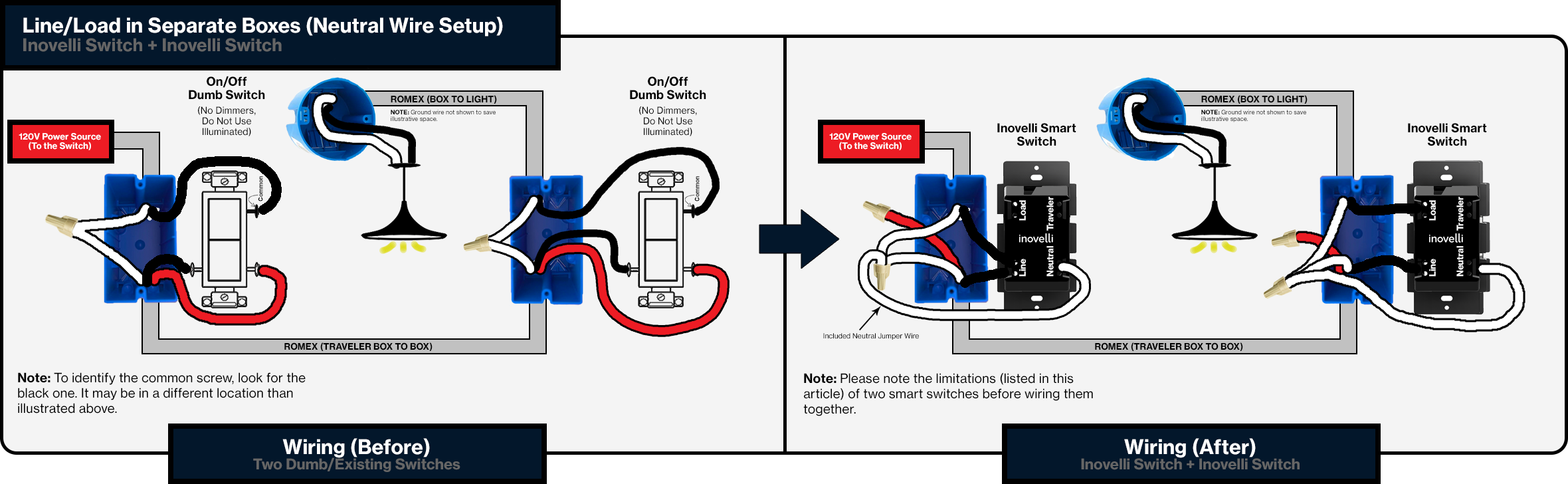

Don’t want to hijack @rohan helping you, but I noticed something you said that does not sound right. The non-load-controlling switch should only have a hot and a neutral connected to it (and a ground). The load conductor is only connected to the load terminal of the switch controlling the load and not the other switch.
If power originates in the non-controlling light switch box, then you would have the incoming hot and a hot going to the other box both connected to the line terminal. That may be what you meant.
I can’t quite get my head around how you have described it. You might want to post the wiring diagram you used and confirm that you’ve actually wired to conform to that drawing.

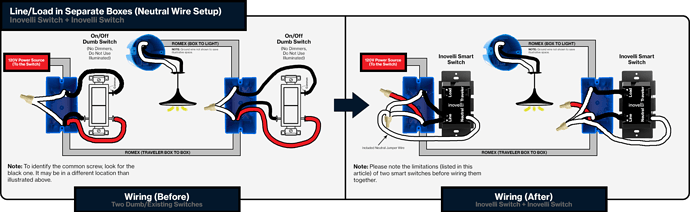

I mean it’s wired exactly like this: Blue Series Dimmer Switch • Wiring Schematics | Inovelli Help Center
I’m not sure what exactly to call each wire in the second diagram… as that page says “You will have to rewire your setup to a non-traditional way” :laughing:, so please excuse my nomenclature. The important thing is that both switches have hot and neutral connections, and only one of them controls the load.
For the sake of information, you are taking the two existing travelers, and converting one to carry Line power, and capping/abandoning the other unused traveler.
Technically, you could repurpose the abandoned traveler to carry Load from the first box with the Load connected to that switch instead, but as these are both full featured switches, it isn’t necessary and adds unneeded complexity.

The bindings look configured correctly to me.
