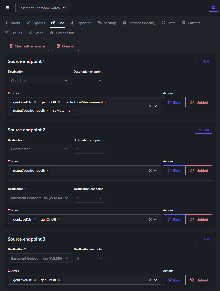

If you are using zigbee bindings, you will need to make sure the paddle switch (endpoint 2) is bound to the light portion of the canopy module (endpoint 1). Then, you have the favorites/configuration button on the switch (endpoint 3) bound to the fan portion of the canopy module (endpoint 2).
I’m pretty sure I did everything right, how can I check to make sure of this I’m still having the issue.
I am not sure on the specifics for ZHA, as I use Z2M, but here is a screen shot of how I have mine set up with Z2M if it helps…
Endpoint 2 on the Dimmer (VZM31-SN) to endpoint 1 on Canopy Module (VZM36)
Endpoint 3 on the Dimmer (VZM31-SN) to endpoint 2 on Canopy Module (VZM36)
