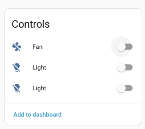

I just installed a Blue Series Fan/Light Canopy Module using ZHA and lots of the parameters are duplicated. Any advice?

I’m pretty sure one set is for the fan and the other set is for the light. I would expect them to be named differently though.

There’s a light switch that works correctly, a fan switch and another light switch that seems to be a duplicate of the fan switch. Each parameter that should be there once, e.g. firmware version or default move rate, is duplicated. Not sure if it’s because it’s using the incorrect quirk - zigpy.quirks.v2.CustomDeviceV2. I previously had a King of Fans controller that worked perfectly with ZHA, it just had a terrible Zigbee reception so decided to pay the premium price for Inovelli to finally stop having issues so hoping that this is easy to resolve.

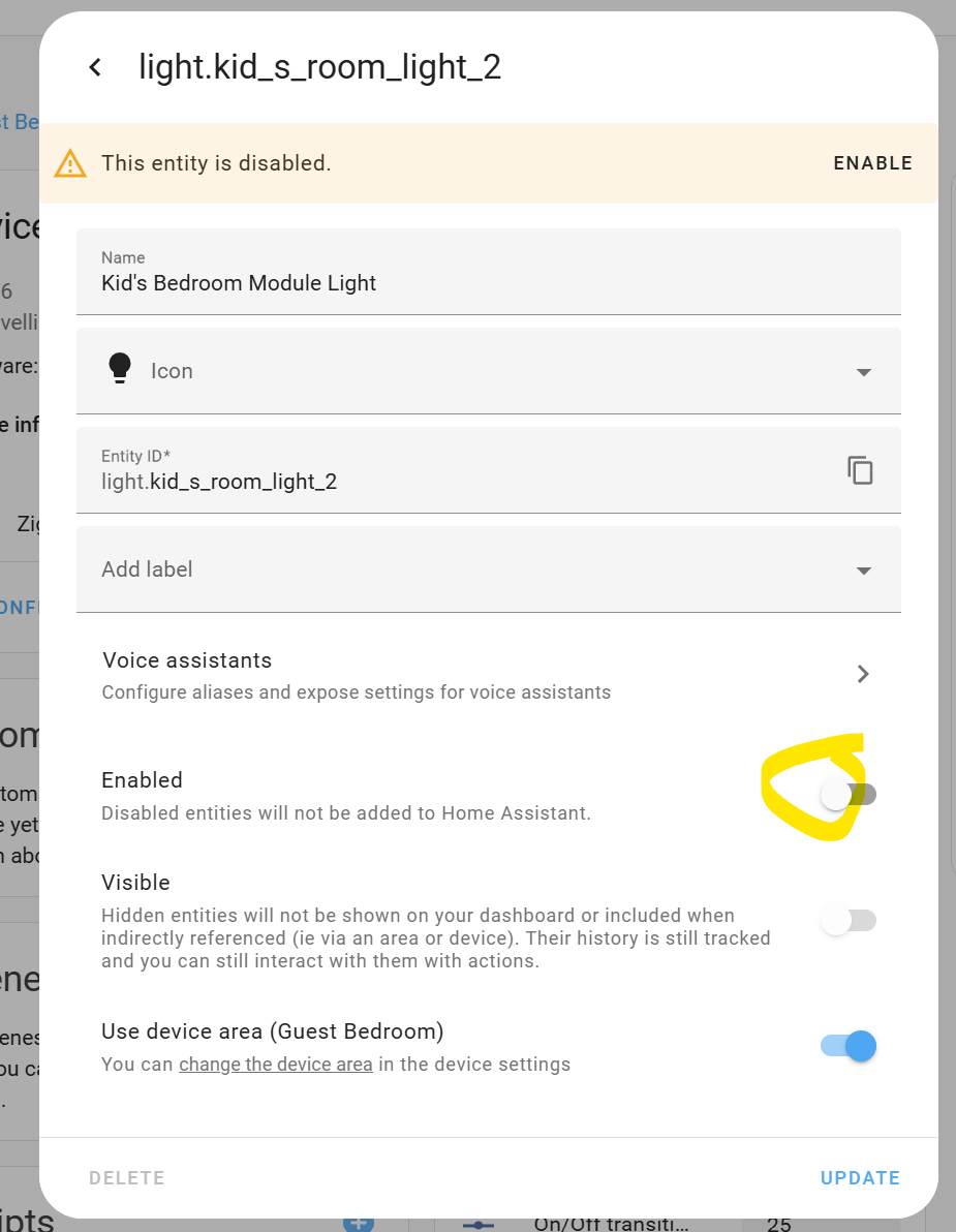

@can-haz-fan if you would like to just use the fan and light with ZHA, you can just hide the light endpoint that is a duplicate of the fan. This endpoint is only their for compatibility with other devices that don’t support the fan cluster. I don’t remember which one is for the fan, but find the one that is, click on it, click on the settings, and disable it:
You can also disable all the configuration entities if you don’t need them (or ignore them).
