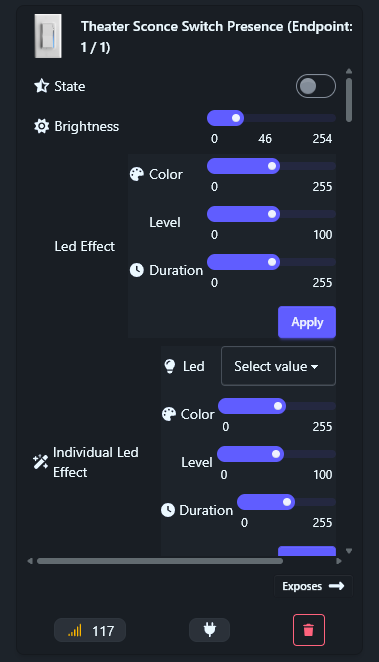

Sure thing! Here is the switch in the group:

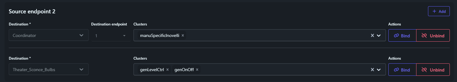

And here’s the group binding on the switch:
