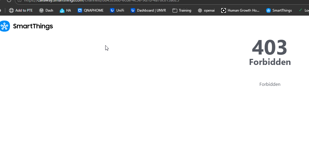

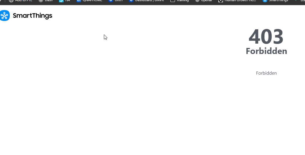

Went to try and change drivers and I noticed that when I click on the Inoveli driver I get a 403 page:
“ SmartThings Channel and Drivers ”
image1060×576 16.5 KB
All the other drivers I have load up the channel information page just fine. Is there a new link for the blue switch drivers?
Update - I was able to approve by accessing it again via the link on the Edge Driver wiki here. After that, when I click the link, it takes to the normal page for enrollment. Not sure why or how that happened.

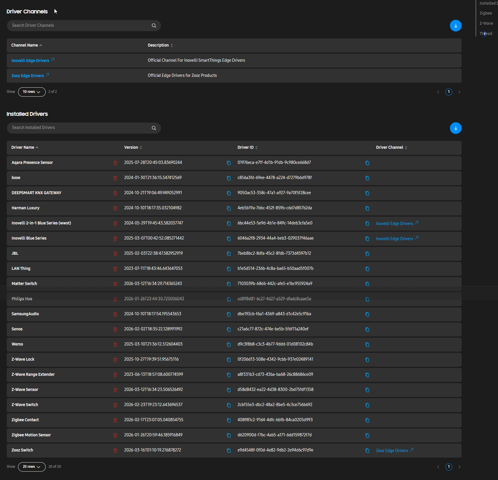

Also I noticed that I have a new Matter Switch driver ( I didn’t add it) that was updated the same day this happened:
Matter Switch 2026-03-12T16:34:29.714365243 7103039b-68d6-442c-afe5-e1bc955924a9

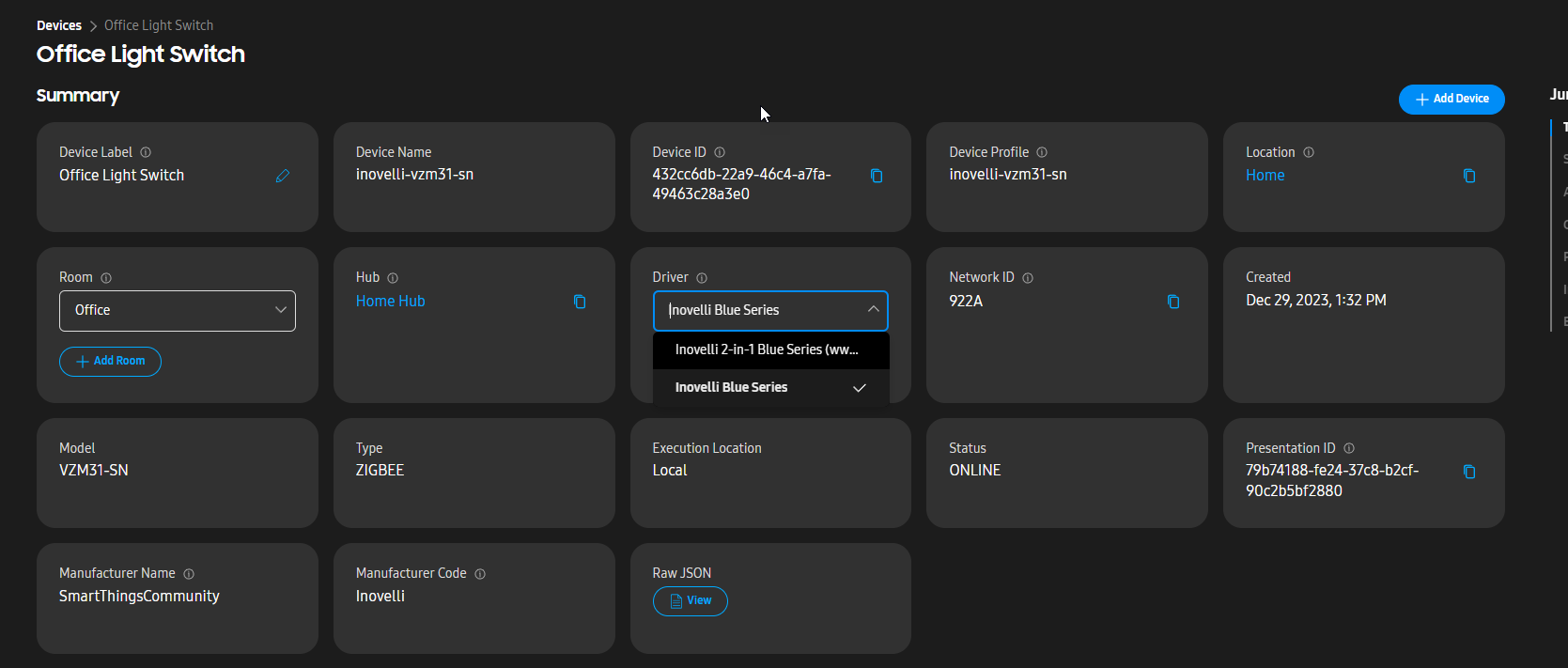

You definitely have some driver issue going on. You should have been able to go to the default Zigbee Switch driver. Go into the Advanced Web App, click the 3-dot menu and select Advanced Users. Select your hub and then select Installed Drivers. (Or go to that same location however you get there in the phone App). Scroll down. Do you see the Zigbee Switch installed?
Yep, Blue 2 in 1’s, about 20 - all doing the same thing.
Driver wise, I don’t see a generic zigbee one. Here’s a screencap of them all:

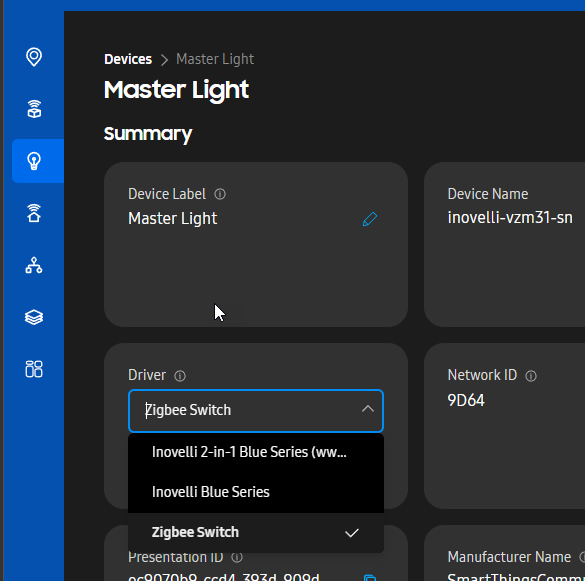

And trying to change the Driver on the device I see this:

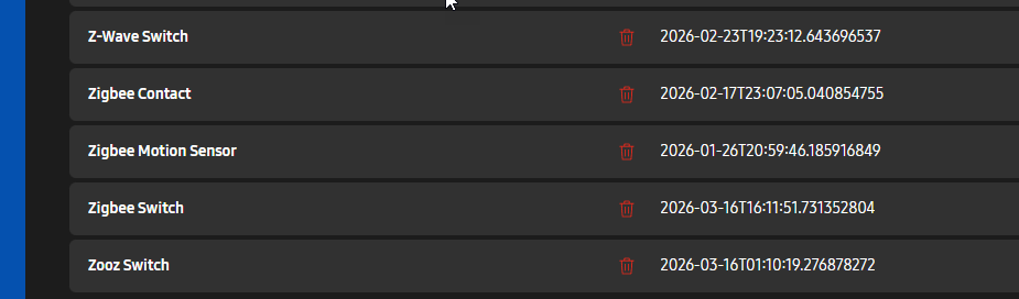

So you don’t see the default driver because it’s not installed. The default drivers are automatically added as a channel that is part of the firmware. The fact that you’re are missing at least the Zigbee one may be part of your problem, but it’s hard to say. You might want to post in the SmartThings community to see how you go about getting those back.
so downloaded it from here and got it uploaded but still no change sadly. Swapping between generic and the inoveli driver. I’ve been wanting to move over strictly to Home Assistant tbh. This just makes it that more urgent. Hopefully binding isn’t terrible to remove and adding to HA directly for zigbee
