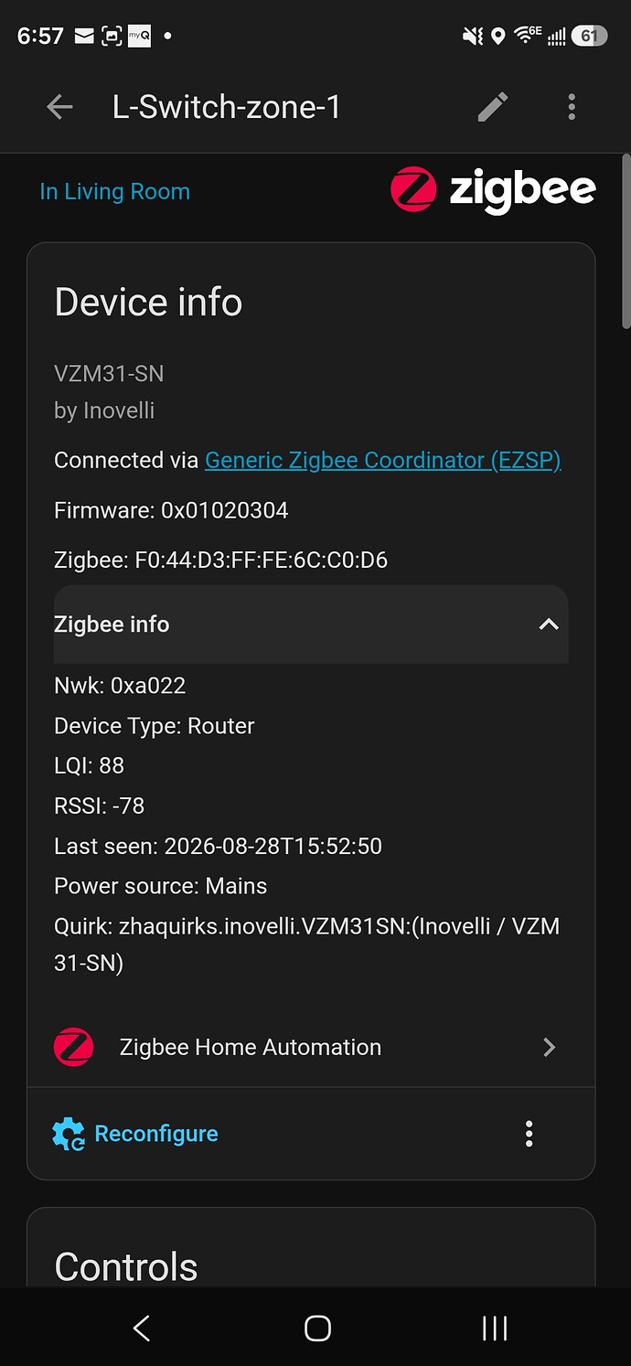

I have a blue series smart dimmer
It’s working for a day or so then grey out on home assistant. The switch itself is still powered on and the LED responds when turn off and on.

For zigbee i have – Itead_Sonoff_Zigbee_3.0_USB_Dongle_Plus_v2
