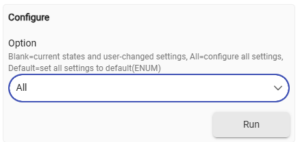

I got it working. I tried all the things above to no avail. But then I used the “Configure” command in the Hubitat driver and selected “all”. I’m not sure which parameter(s) that corrected, but its working now. Thanks for the support and assistance!
