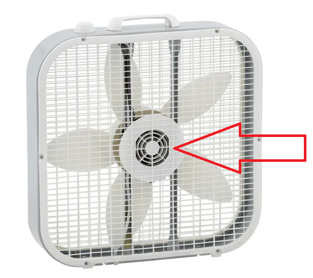

Wow, this inquiry really sparked a discussion. The fan I have is a Lasko 3-Speed box fan. It looks similar to this but I’m not sure the exact model.

I wonder if I could squeeze project Cheryl inside the fan shroud. That would solve all of the receptacle issues.
That may be harder to wire in, but could attempt it.
