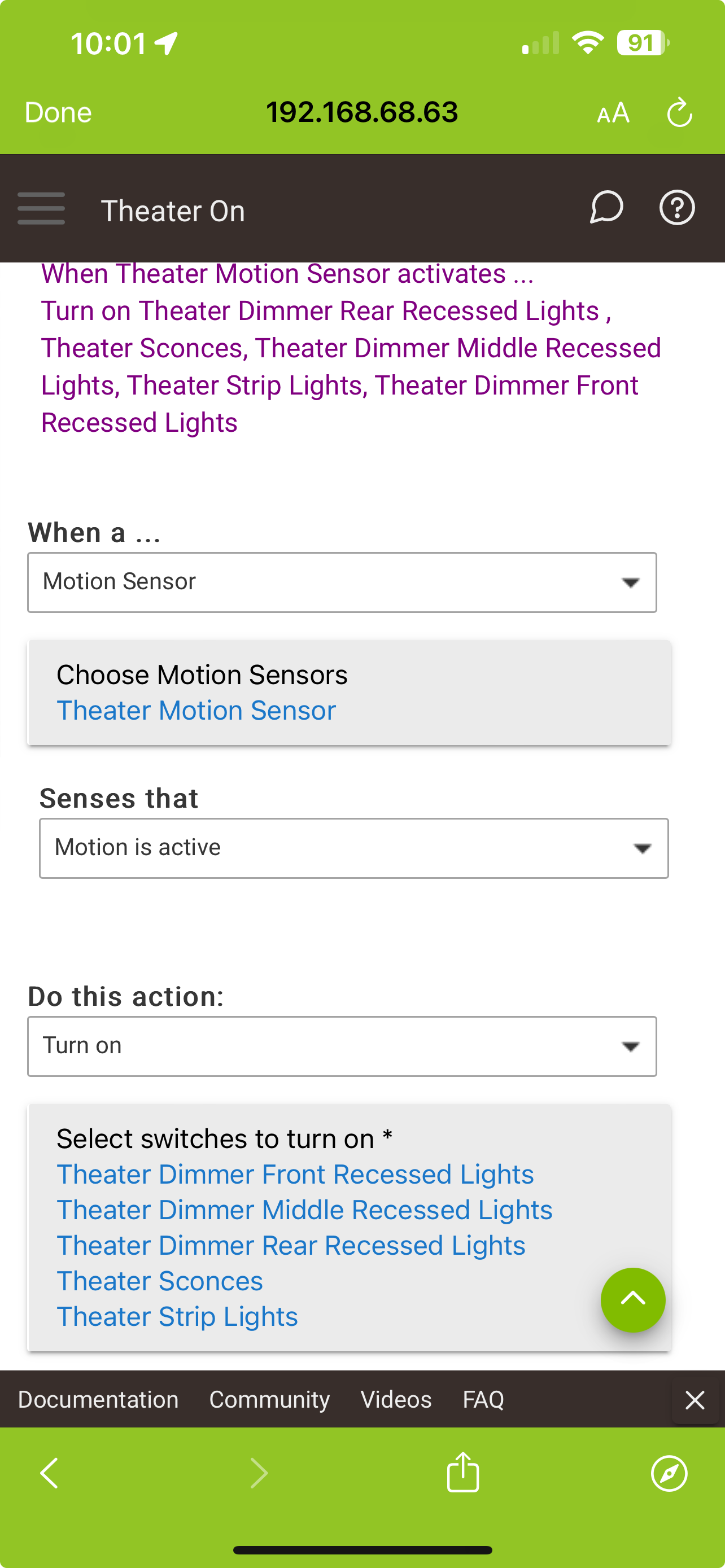

I’m using Hubitat with blue switches in dimmer mode for dumb bulbs (ramped up to maximum). Simple Rules to control the blue switches to turn on and off the switches with a motion sensor to hence turn on dumb bulbs. Not working to turn on dumb bulbs. Sensor does turn on other hue bulbs in room but not switches. Any thoughts.
Post a screenshot of your rule.
The dimmers are blue switches connected to dumb bulbs.
