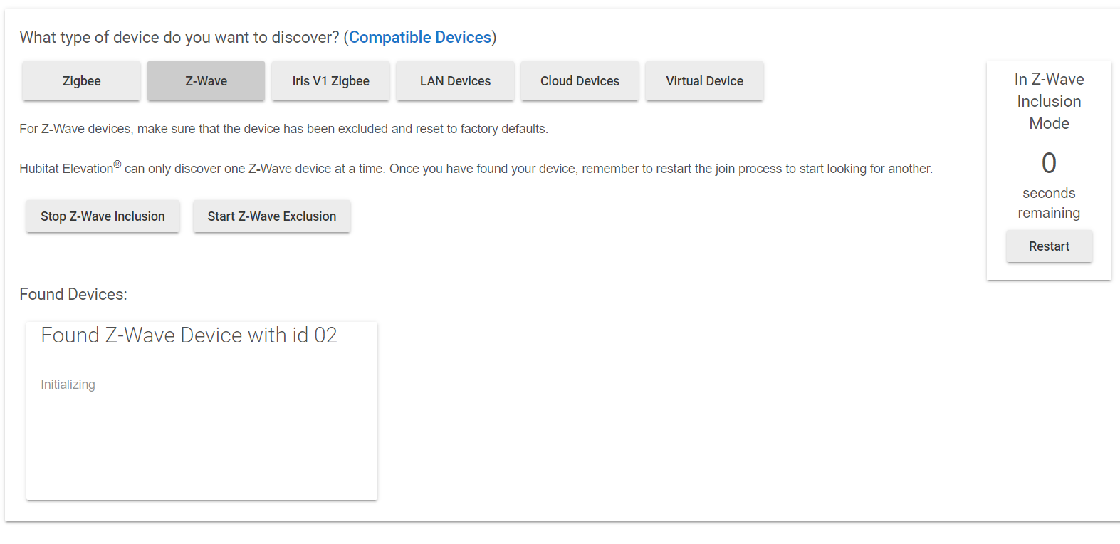

Ok, wire up 1st Inovelli dimmer. I get to this point
Nothing in logs, device never comes online. When I put Hubitat in exclusion mode, I get “Unknown device excluded”
Tried 3 other dimmers (bought 20 dimmers, 10 switches). All the same, stuck on “initializing”. Now at this point I have excluded, factory reset, rebooted Hubitat, cut power to inovelli devices via electrical panel, 4-5 times. I have also tried from ground-zero, both z-wave “secure join” modes (all secure and locks/garage doors only). Resetting everything to ground-zero before switching these modes.
This is extremely disappointing. Already pulled off the tabs on some of the dimmers. Wondering if I should be requesting a refund and go HomeSeer? The 2 WD200s I have seem to work flawlessly, I can unpair and repair over and over again. Connected one of the Levitons I just unpaired this morning, paired no problem. I’ve tried 4 Inovellis dimmers straight out of the box, brand new… All the same… stuck on initializing during z-wave inclusion.

ok, after another nuclear reset session and bringing the hubitat hub into the same room as the first device, things paired, then i kept pairing and reparing… things seem to be working. For whatever reason, but HomeSeer and Leviton were able to pair with the hub in its original spot…
