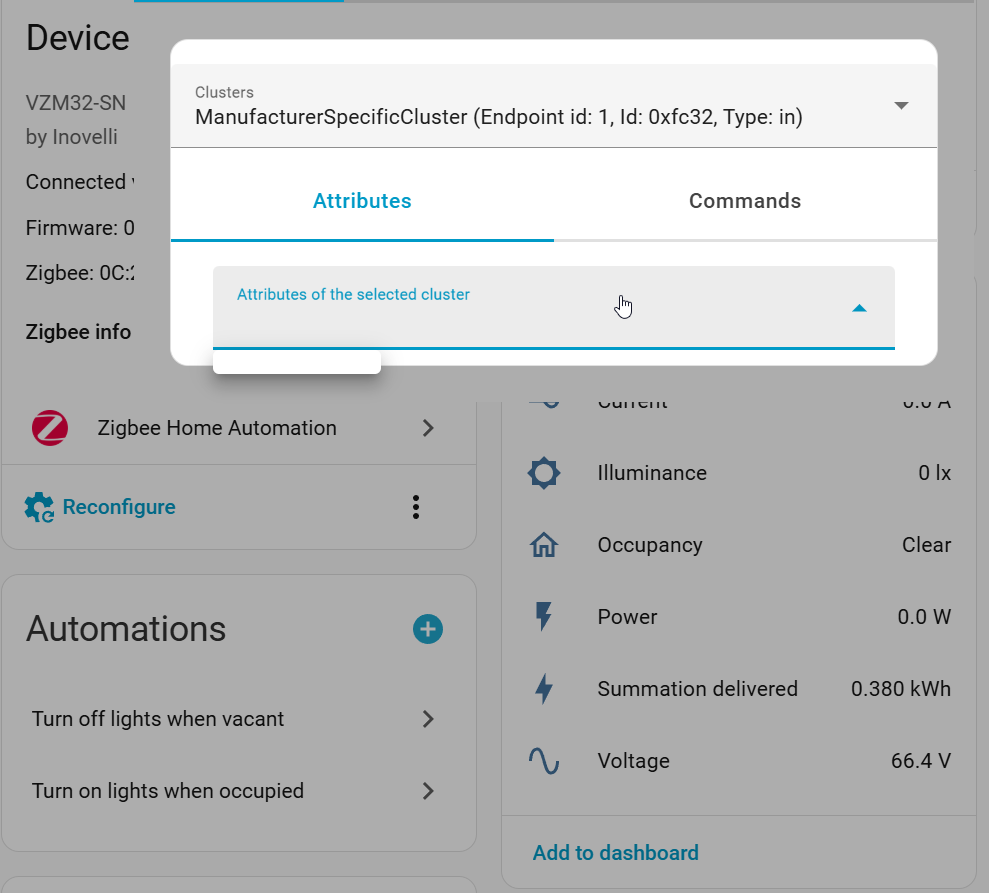

I recently purchased a VZM32-SN switch with mmWave presence detection. I’m running into an issue trying to follow the documentation to change the Y-axis range (room size preset 2 is too close, 3 is a bit too far).
These settings should be in Cluster 0xfc32, but nothing shows up. The page indicates that I might need to set the mmwave_target_info_report (param 107), but it also isn’t showing up.
0xfc31 settings work just fine and show all attributes, but 0xfc32 is empty. How can I adjust the y-axis on my switch?
