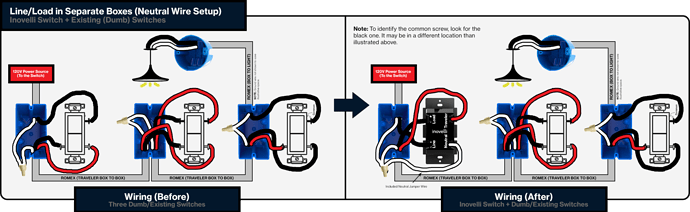

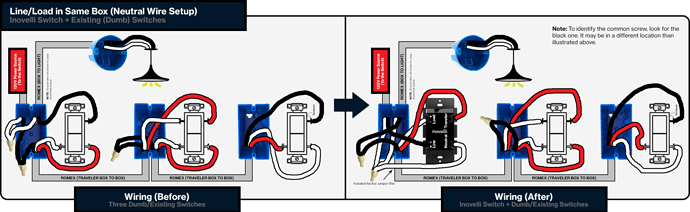

As far as needing an Aux switch, provided you are using a Dimmer and not an On/Off switch, then no, Aux switches aren’t necessary and you can utilize your existing dumb switches… But, you need to have the Line and Load in the same box (see first image below, and not the second image below)
