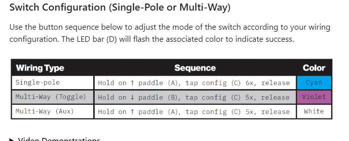

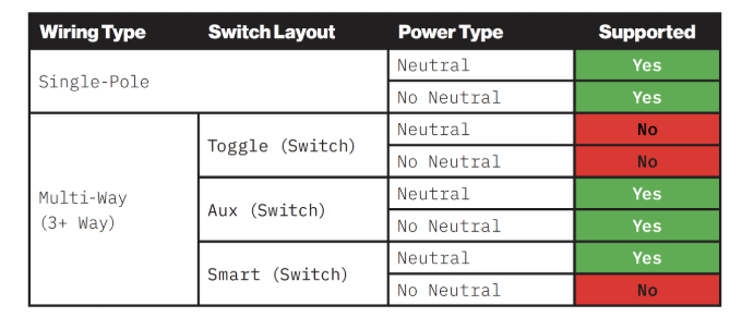

Since the VZM-32-SN does not support Toggle, shouldn’t the documentation (Blue Series mmWave Presence Dimmer Switch • Manual | Inovelli Help Center) and firmware be changed so the smart switch can not go into this mode?
