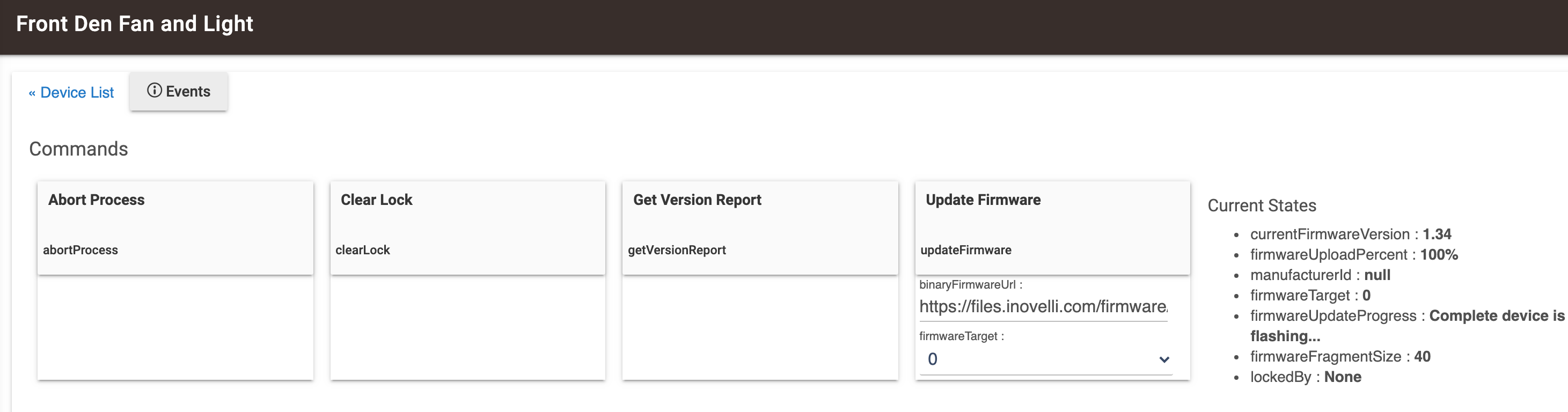

I pasted in the 1.36 gbl URL and clicked the Update Firmware button. This was the fastest yet, taking just under 14 min. As you’ll see from the screenshots below it said the Upload was 100% and that it is “Complete device is flashing…”

Upload shows 100% and Update Progress is: Complete device is flashing…
But now is has been over 20 minutes saying Complete device is flashing…
So how long should that (what I hope is the final step) take? Will the message change when the flashing is complete? The instructions stop after saying to click the Upgrade Firmware button.
Good news, it should be finished :slight_smile:
Idk why that verbiage isn’t updated as it’s confusing, but when it says, “Complete device is flashing”, it means it’s completed, so you should be good to go.
