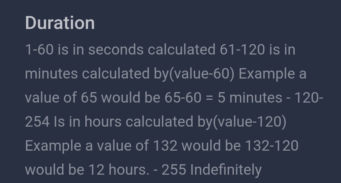

Neat integration! I built something similar but using NodeRED as the management/coordination. I’m using Z2M, so I’ll probably stick with what I have as it’s already working. I also wrote in a way to display multiple notifications at once by using individual LEDs instead of the entire bar.
One thing I noticed is your docs claim the default maximum duration is 254 seconds, but I don’t think that’s correct. Unless the Z2M description is incorrect, the maximum time (not including indefinitely) is 134 hours.
This should be correct.
Oh, hmm… I guess I don’t know how the 0-255 values map to actual durations. I think I based it (at some point) off of what I saw in the interface that ZHA gives for sending notifications. I’ll go back and look again.
If anyone has a quick reference for the zigbee parameters for this, I’d appreciate it. I always have a hard time finding them. I think I only ever found anything on this community site & nothing official.

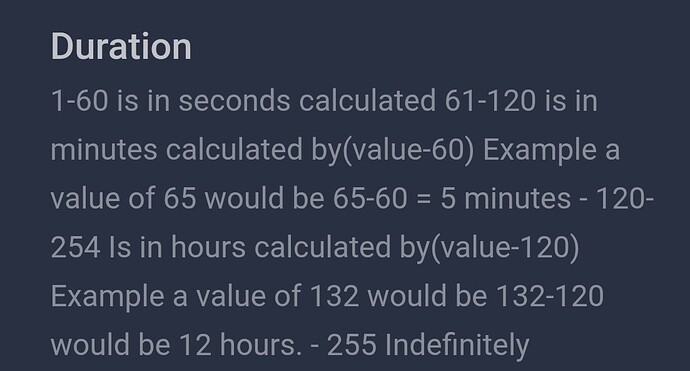

Here’s a screenshot of the Z2M interface.
Thanks, I found another source stating the same here: Control LED color beyond 255 seconds - #5 by PJF.
I’ll update what I implemented & documented. Thanks!
