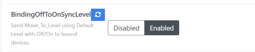

BindingOffToOnSyncLevel= Enabled

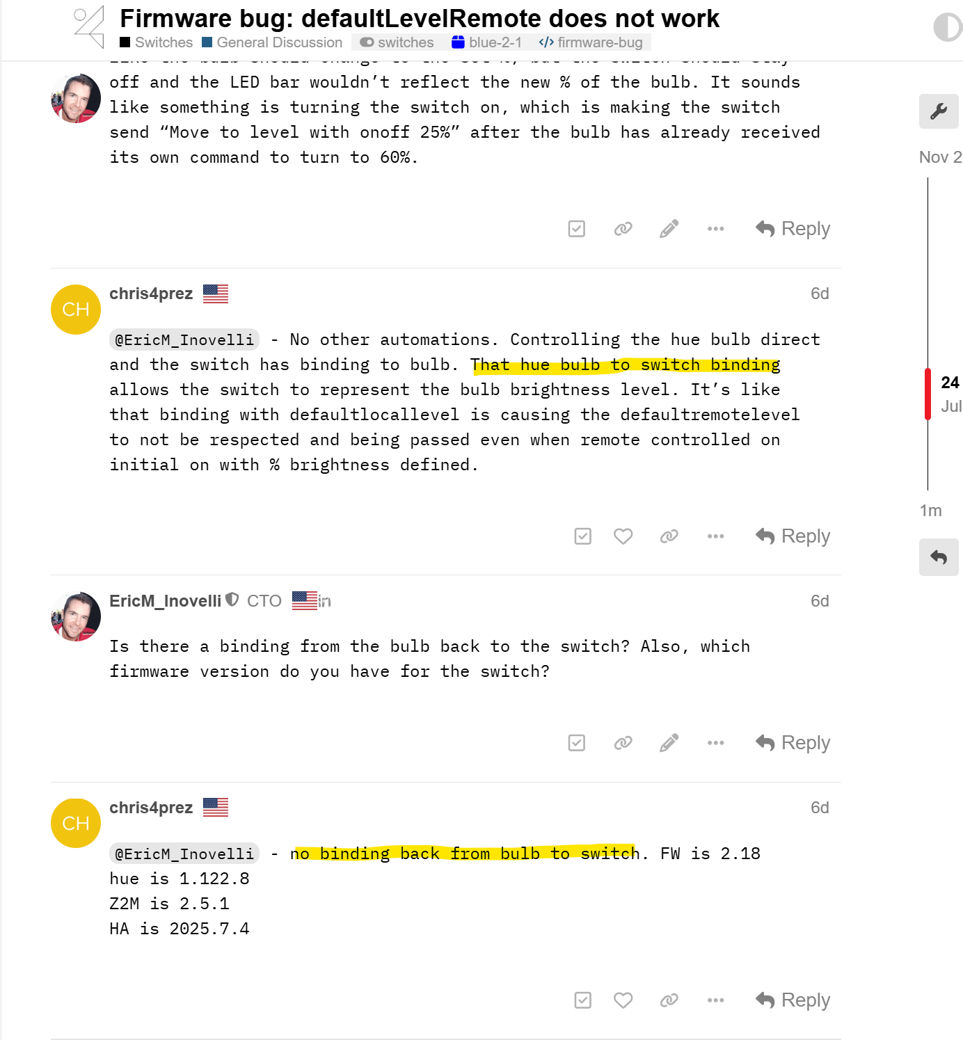

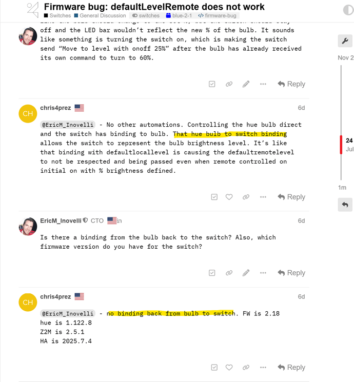

Are you controlling the hue bulb or is the hue bulb in a group? Is there any other automation that is turning the switch on as well? From the description (if there is no group or other automation) it seems like the bulb should change to the set %, but the switch should stay off and the LED bar wouldn’t reflect the new % of the bulb. It sounds like something is turning the switch on, which is making the switch send “Move to level with onoff 25%” after the bulb has already received its own command to turn to 60%.
@EricM_Inovelli - No other automations. Controlling the hue bulb direct and the switch has binding to bulb. That hue bulb to switch binding allows the switch to represent the bulb brightness level. It’s like that binding with defaultlocallevel is causing the defaultremotelevel to not be respected and being passed even when remote controlled on initial on with % brightness defined.
Is there a binding from the bulb back to the switch? Also, which firmware version do you have for the switch?
@EricM_Inovelli - no binding back from bulb to switch. FW is 2.18
hue is 1.122.8

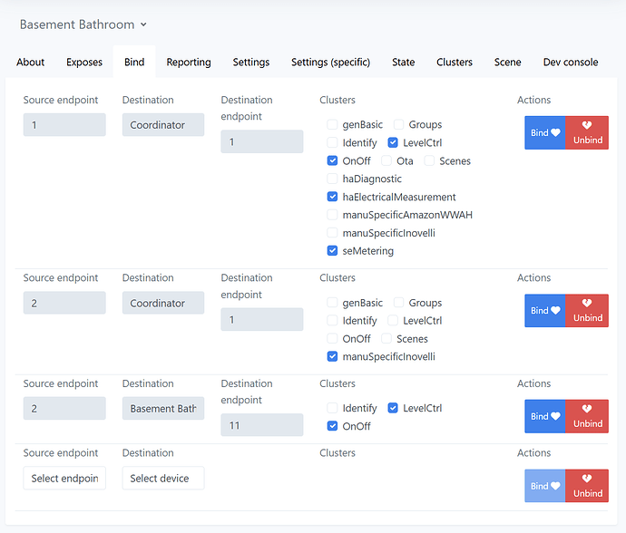

Edit: I was just reading back through your posts and want to clarify. On the binding screen for the Hue bulb, can you take a screenshot? This is what I am a little confused about:
@EricM_Inovelli - I’ve been able to reproduce the issue without needing to expose to Homekit and/or use voice commands. See the Video attached with all the screenshots. I provided my full setup.

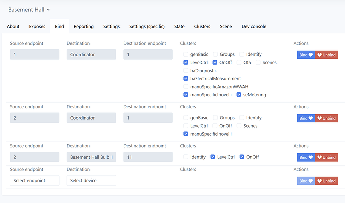

Switch - Expose and Bind screenshots
Bulb - Expose and Bind screenshots

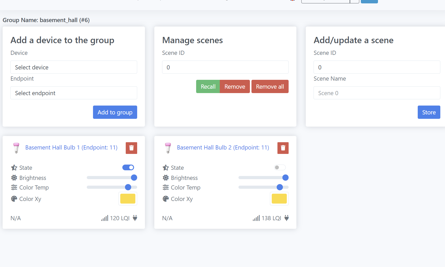

Screenshot of the group the bulb is also in. (So I can turn on / off all the lights in that room. No switch or binds or automation associated with that group whatsoever)

I went over your screenshots and test case and I don’t see anything that stands out. I have tested the same setup and can’t replicate what you are seeing. :frowning: The part that is very confusing to me is this part:

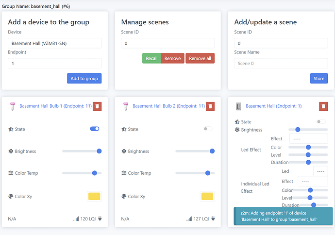

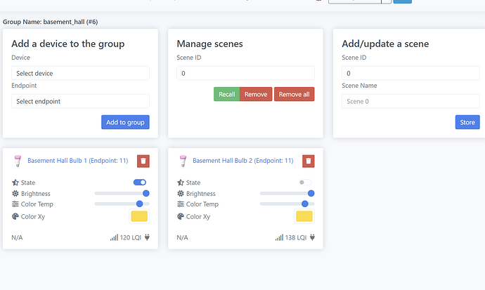

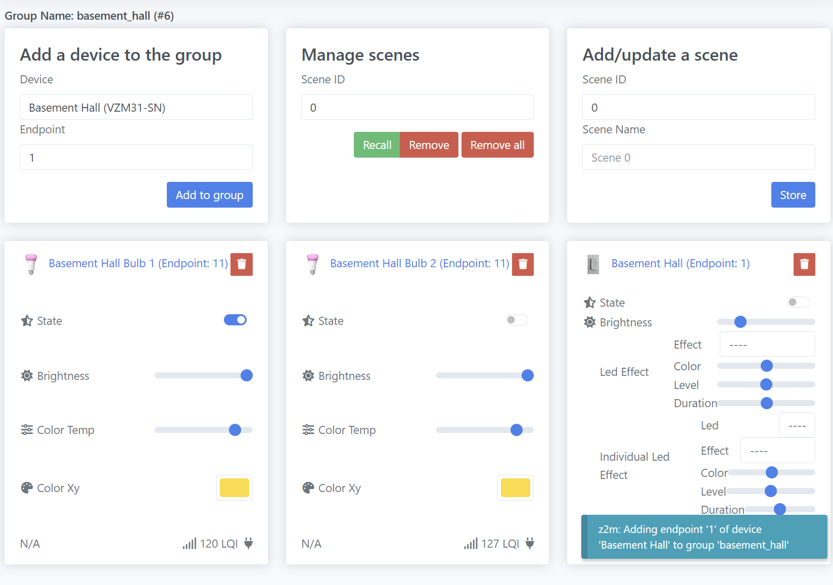

@EricM_Inovelli - I made a HUGE revelation today!
Yesterday, I finally had time to start working on my notifications to be presented on the LED bar. i.e. Home Alarm arming change to pulse red for 45s during arming, then change color to Red for the LED Bar when armed, etc.
When I implemented this I created a Z2M Group and added all my Inovelli Exterior wall w/ door switches & Bathroom wall switches so that I could target a single MQTT payload to adjust all of them in a single go. A byproduct of doing this is the following:
  1. When I action light via the switch it goes to the default value defined. i.e. 25% and the notification bar displays the 25%
  2. When I action the bulb directly via HA and choose say 50% it no longer bounces to the switch default of 25%. However the notification bar no longer represents the brightness %.
Meaning DefaultLevelLocal and DefaultLevelRemote are being honored with the notification bar no longer reflecting brightness level when being controlled via the bulb.
The moment I removed the one switch from any Z2M Groups and only leave it bound directly to the single bulb via the switch bind.
  2. Turn On and Off via the Switch. Then action the bulb directly via HA and choose say 50% it turns on at 50% then immediately defaults to the 25%.
  3. Make any changes via the bulb direct and the notification bar displays the brightness % when the bulb is directly controlled.
Meaning when the switch is not in a Z2M Group and bound to a bulb DefaultLevelLocal is respected, led brightness is reflected, after action’ing via the switch DefaultLevelRemote is not honored and reverts to DefaultLevelLocal with led brightness reflected on the notification bar.
@EricM_Inovelli - Based on my last posted comment revelation and your comment about logging. Here is my test scenario performed both with the switch in and not in a Z2M group.
Not in Z2M group. Notification LED Bar reflects on state and brightness % whether bulb or switch is controlled. However, remote default appears overridden by local default brightness %.
In Z2M group. Lose ability to have LED Bar reflect on state and brightness % when bulb is controlled direct. However local and remote default brightness % appear to be honored.
