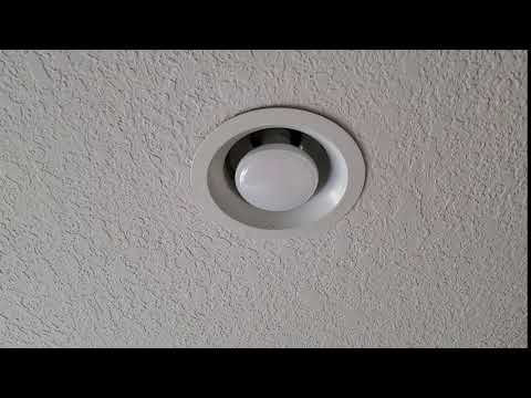

I’ve noticed, if I set the brightness of the dimmer to ā€œ1ā€ and I turn the bulb on at the dimmer (LZW31-SN), the bulb comes on to a value much brighter, say 10, and then dims down to 1 as shown below:
However, if I turn on the light from z-wave or the GE accessory switch, the light turns on to the preset value of 1 as shown below:
the dimmer is set up as a 3way using a GE accessory switch with neutral. The rest of the configuration values are pretty much set at default.
Anyone else seeing this?
