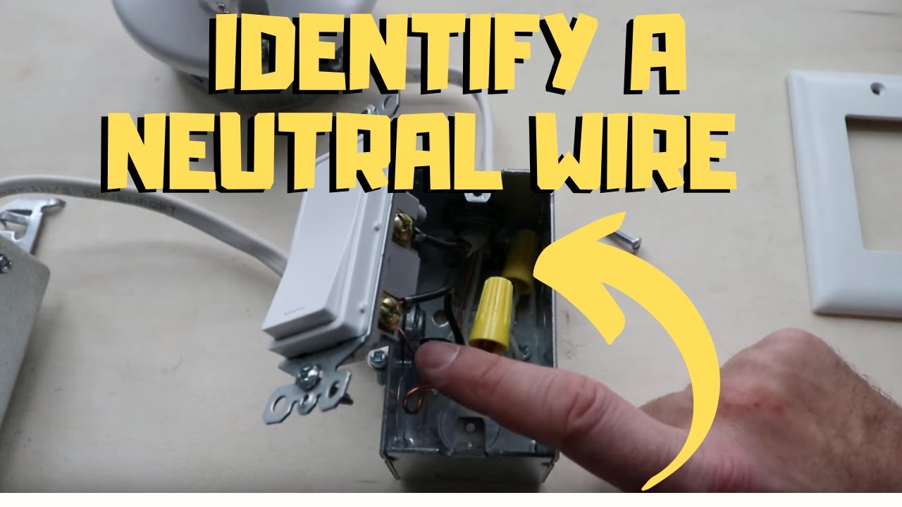

I watched the video. The summary is: the white wire is neutral.
If you see my thread with @Bry , the wiring for my 3-way configuration is different. The white is HOT/LINE.
The question is whether I can have a smart presence switch instead of an aux switch at the remote end. Is this doable?
