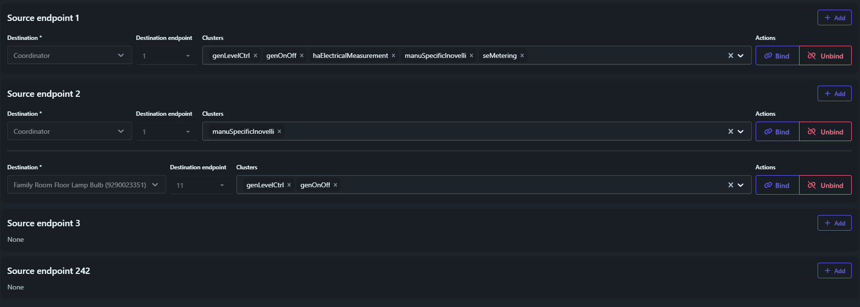

On my Hue bulbs the switch (endpoint 2) binds to endpoint 11 on the bulb:
Hope this helps,
Craig

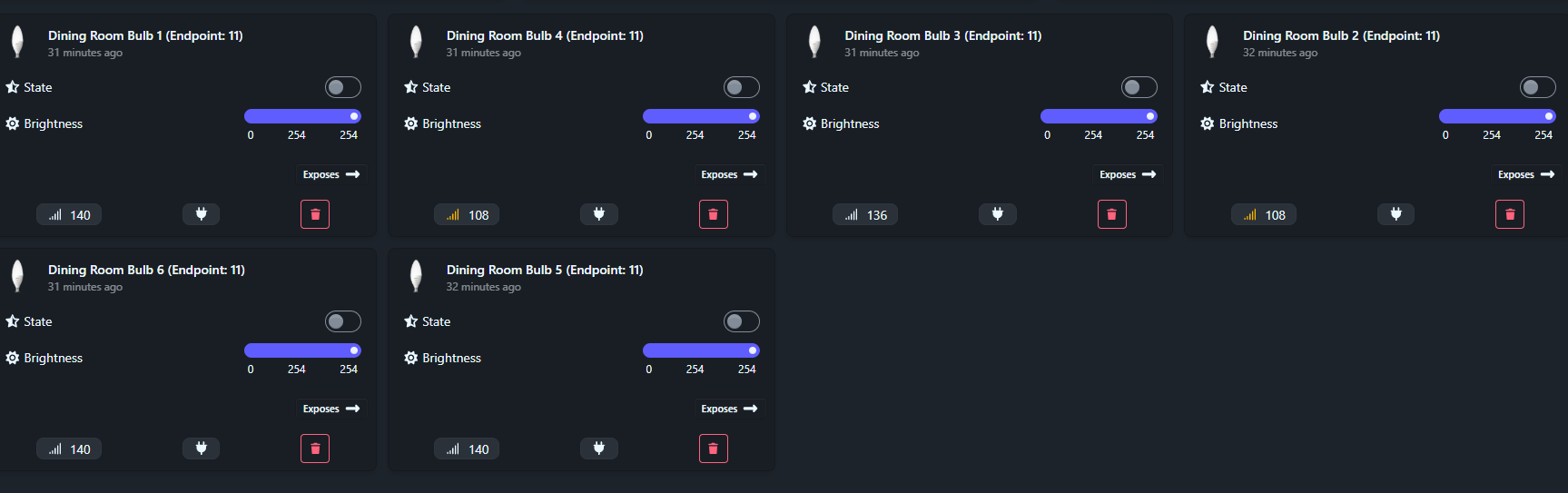

I also have a group of Hue Bulbs, all bound to Endpoint 11, the switch on endpoint 2, binds to the group:
