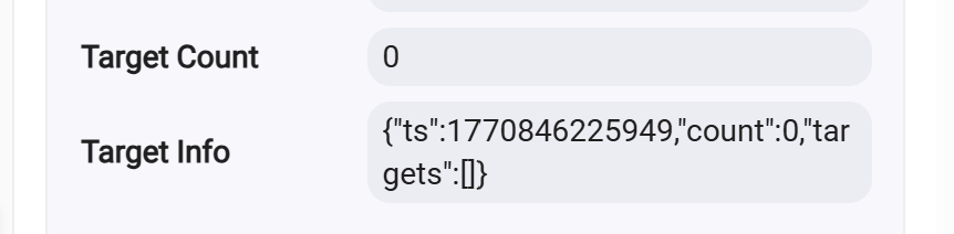

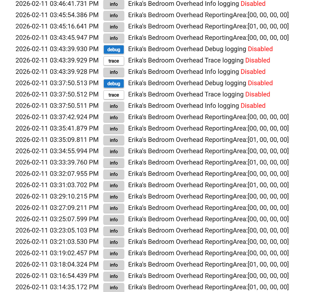

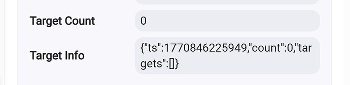

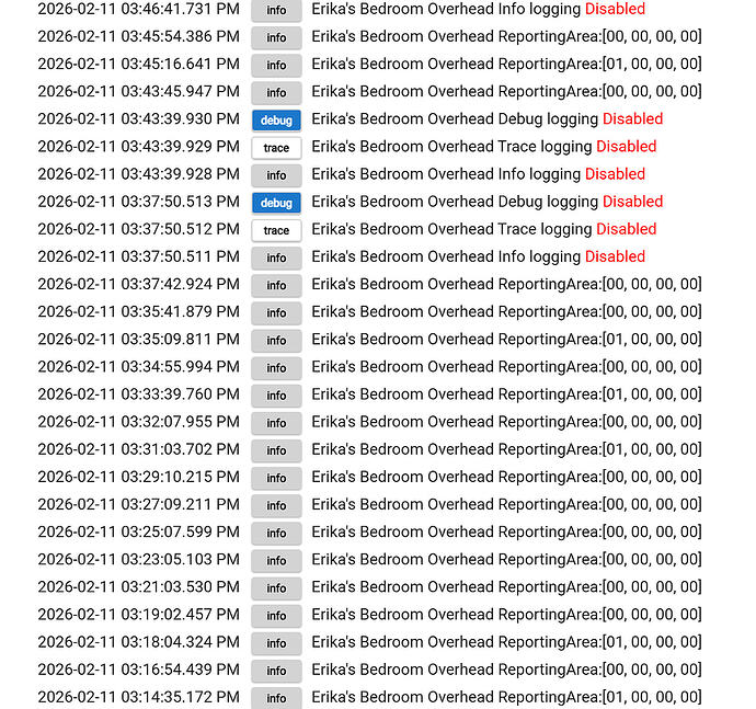

Very cool app that runs on Docker desktop and leverages the Hubitat maker API. I’m working with the devs doing testing but not getting live target data updates when I set parameter 107 (live target info report). The two state variables appear but they always show 0 targets even when the sensor is detecting motion. I am running the 01-30 driver but am wondering if there is some other trick I need to perform to get target info to populate? Maybe not working on firmware v1.0?
I have a support ticket open on this currently. It could be a binding issue in the driver that can be worked around using the “Bind” command. This is working for some so I believe the bug is related to a settings inconsistency. I have “light on presence behavior” set to “disabled” for example.
The problem resolved itself when I added a second mmWave switch to the environment. The second switch worked correctly with this app out of the box and, inexplicably, the first switch started working as well. It is much easier to set up a room using this visualizer!
