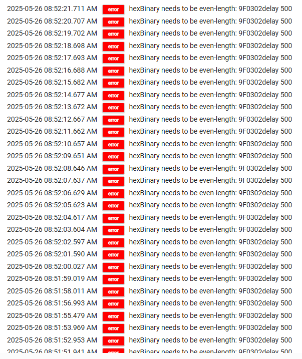

I am running Hubitat C-8 on the latest version. I have been having intermittent command issues with my Zwave switches. I have a few types of red switches. I have one Inovelli Dimmer 2-in-1 Red Series VZW31-SN that is having an issue with multiple errors. It is showing a hexBinary needs to be even-length: 9F0302delay 500 error. I am curious if this is contributing to my issue. I have the most up to date Inovelli Gen 2 driver from HPM. Originally this issue was present at firmware 1.02. I flashed to 1.04 to see if that would help, and there is no change. Could this be contributing to my intermittent automation issues?
For example, I am using the LED dashboard to flash when the door is unlocked. The door is showing unlocked and the LED mini dashboard is showing it should be in the unlocked state, but the LED was not actually updated to a flashing state.

I haven’t used Hubitat in years, but have to ask if the “Gen 2 driver” that you have installed is the one for the old LZW series and not the new VZW switches which I believe are Gen 3???
