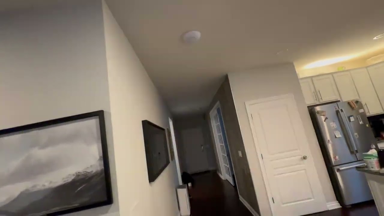

During a power outage test, when the PowerShare system takes over, I notice the Hue bulbs on these circuits begin flashing rapidly. Voltage readings taken at the switch show:
  • Neutral to Load: ~0V
  • Neutral to Line: 119V
  • Line to Load: >180V!! or nearly 0V depending on probe orientation
If I reset the switch via the air-gap, the bulbs return to normal and voltage readings stabilize.
This happens on multiple circuits with Inovelli Blues in smart bulb mode. It seems like the switch enters an undefined state during the switchover, possibly outputting phantom voltage on the load side and confusing the smart bulbs.
Has anyone seen similar behavior during backup power transitions or with inverter-based systems? Any firmware fixes or recommended wiring workarounds?
Video:
