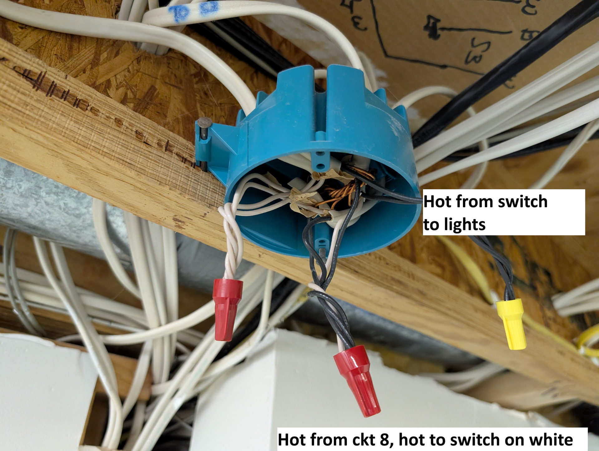

I think I found the junction box.

This junction box has a white and black tied together.
With a non-contact tester I confirmed power present when circuit 8 on and power not present when circuit 8 off.
The yellow-wire nut black/black has power when the basement 3-way switch is on and doesn’t have power when it’s off.
I think I need to re-wire this so that the 2-wire to the switch gets hot and neutral and the 2-wire to the lights gets hot and neutral.
Is that correct?

Ideally, yes, get a hot/neutral over a 2-wire to the Inovelli switch.
But you’re are going to have to draw the whole thing out to make sure you have enough Romex going to the right spots. There is a reason that this was wired as a switch loop, and that’s usually to save on an additional Romex.
The problem is that in the Inovelli box, you only have a 2-wire and a 3-wire. The 3-wire goes to the other box. That leaves the 2-wire, which probably goes to that J-box. You need a load wire, and your problem will be trying to figure out how to get a Romex that feeds the lights to the Inovelli box.

From the J-box I ran hot and neutral to the 3-way. That’s wired to LINE and NEUTRAL on the Inovelli switch.
Also from the J-box I ran hot and neutral to the lights. They are powered all the time.
The 3-wire runs from the Inovelli switch to the Aux switch carrying neutral (white) and traveler (red). The black is unused with a wire nut and tape.
I removed the bypasses I had installed.
The Inovelli switch is in SBM and configured to work with the Aux switch. I set up a Zigbee binding with the switch and the lights. It’s all working perfectly!
