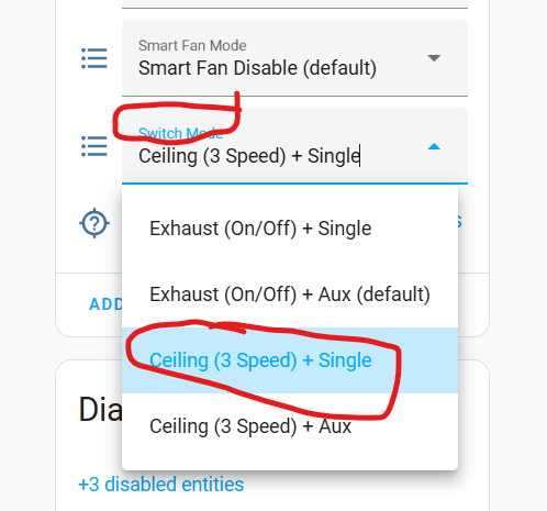

By default, I believe the switches operate in an On/Off mode (i.e., for controlling a single-speed bathroom exhaust type fan), and don’t provide speed control.
If using Home Assistant, there is a setting “Switch Mode” that lets you choose between the Exhaust fan mode, and a 3-speed controller.
If not using Home Assistant, there is a manual button-tap sequence (you’ll have to check the user guide) to set this.
