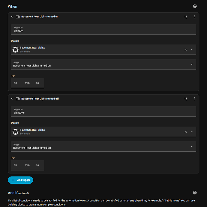

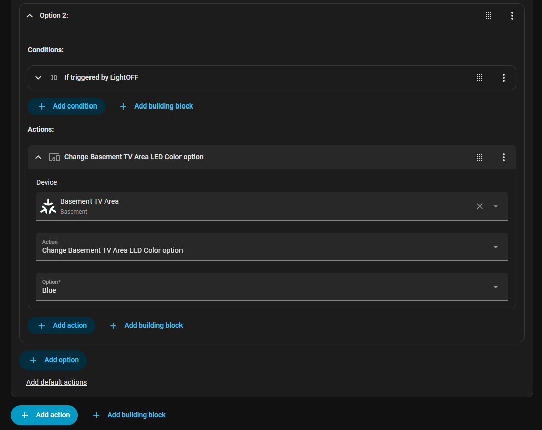

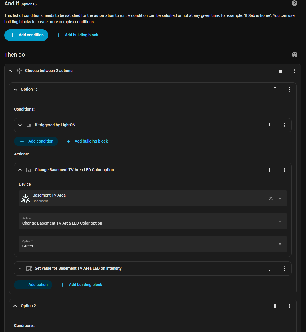

I am trying to set some LED notifications on home assistant using Inovelli White Switches. I’ve searched other forums but can’t seem to find a topic on this. Apologies if there’s another thread already but I can’t find an answer.
I am trying to make a simple automation to set the LED color as a notification when the garage door is open for example. I’m currently just using a light to test the automation. The issue im having is that I don’t have a way to reset the switch to its “regular” behavior of showing the dimmer level with my default color (blue). I can set a green notification when the activation trigger is met, but when the deactivation trigger (simulating the garage door closing) takes place, the light remains green will the full LED bar lit until I close the light and turn it back on again.
I don’t know if I am doing this completely the wrong approach but I do not seem to be able to find the information or automation example for LED notifications for White switches on Home Assistant. Any advice is appreciated :slight_smile: Below is my code in YAML and also in

For the White series, the LED notifications are their own light entity. To start the LED notification you would turn the light on and to stop it you would turn the light off. Looking at your automation, to stop the automation you’re turning the light to blue, but instead should be turning it off.
Also, just as a general rule of thumb you should avoid using the device in automations and instead use the entity_ids. If you were to replace a switch, you’d have to replace the device_id across all of your automations which is a pain, but if you targeted the entity_id instead, then you’d just have to ensure you set the entity of the new device to match the old, and then everything continues working as if nothing changed.

@francesc0 thanks for the response and great tip regarding entity ID. I will modify how I do automations moving forward because you are right that it does not futureproof.
Regarding turning the light off, I had tested previously with turning the LED light off but I found that afterwards I was not able to get the dimming on the LED from regular use so that is why i am returning it to blue. Maybe your boolean option might bypass this issue but I will have to test once I am back home!
@andrewk thanks for the response. Similar to my response to @francesc0 I found i was getting issues with regular dimming when “dismissing” the notification by turning off the LED. In your solution, is the light entity the LED addressable device in home assistant? It seems like I may be trying to do the same thing but I may be doing it incorrectly as previously mentioned by @francesc0 . I will test and modify when I am home later.
That is correct the “light” in my example is the entity ID of the LED bar.
You’re welcome. Turning off the entity_id for LED notifications will return the light bar to the correct brightness. Targeting the device_id results in weird/unususal behaviors, so that could be why you were running into issues.
I wouldn’t suggest using an input_boolean as that’s just going to add complexity (ie, you’d need a second automation to turn the LED entity_id on and off when the boolean changes between on and off). I use it to track my notifications so that if multiple notifications are active and one of them is cleared, then the other notification becomes active.
Thank you for your example automation. Targeting the device_id was indeed the issue. I’ve recycled your automation and it works perfectly! Thanks for your input!
