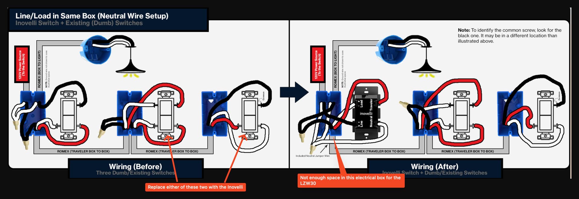

I have a Black on/off LZW30 switch that I would like to use in my 4-way circuit. The problem that I have is that I do not have enough space in my electrical box of the first switch of my configuration to replace it with the LZW30. I was wondering if anyone had a creative way of allowing me to replace either the 3way or 4way switch in the configuration with the Inovelli instead.
I’ve looked a the docs on the Black Series On/Off Switch • Wiring Schematics | Inovelli Help Center page, and all the docs point to the switch being the first switch in the chain.
Can someone recommend a configuration that could work for this?
The two other switches are dumb 3way and/or 4way switches.
