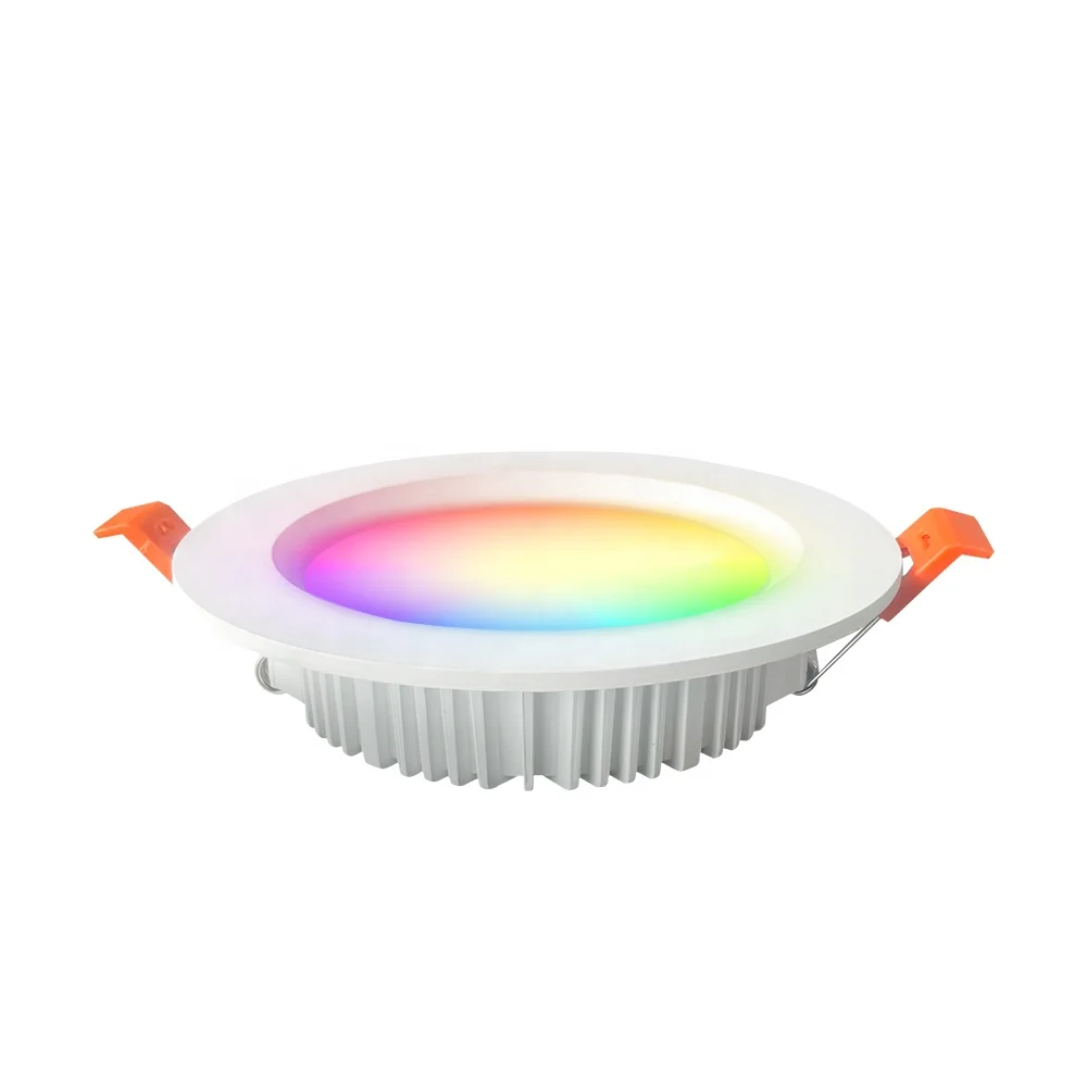

@supreme,
Your experience mimics mine. I had ~84 of the Acuity wafers installed, waited/worked with them for 24 months, finally got the firmware, updated each one and had a huge improvement, but I still had lights going offline regularly. A hard reboot by disabling smart bulb mode would bring them back online, but what a royal PITA.
I finally broke down and bought these directly off Alibaba.
Pro’s:
-The Zigbee Implementation seems rock solid
-They work with groups and smart bulb mode flawlessly
Con’s:
-There’s no adjustable version for aiming/wall washes
-The fit/finish does not seem as high a quality
-They don’t come with their own electrical box, making installation a challenge
-I never got confirmation up or down from Gledopto that they are IC rated, so I’ve had to install insulation space cones as a barrier/air pocket space.
