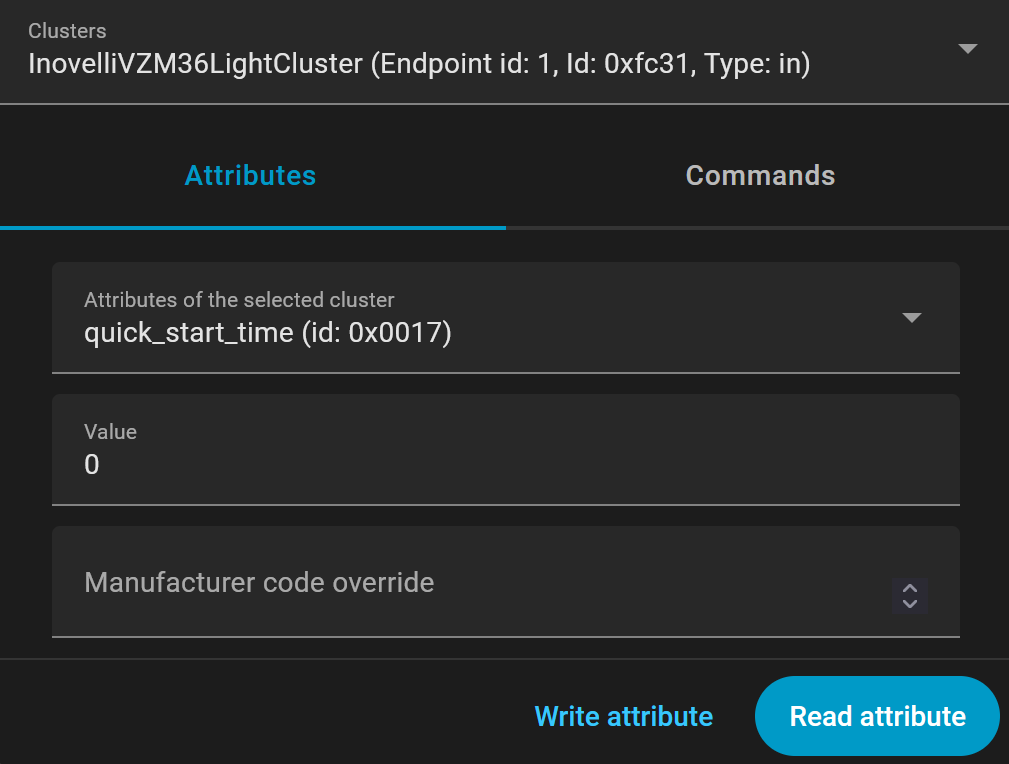

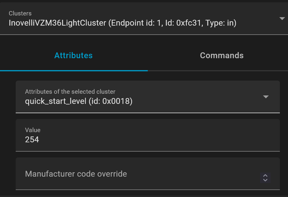

I’m not sure. It looks like Quick Start Level is 254 and Quick Start Time is 0, but the parameters page for the canopy module doesn’t have any information at all on what those parameters mean or do. I also checked the dimmer switch and it appears not to be defined at all there.
Do you know if there’s any information on what values have what effects for that parameter, so I can figure out what I should set them to?
