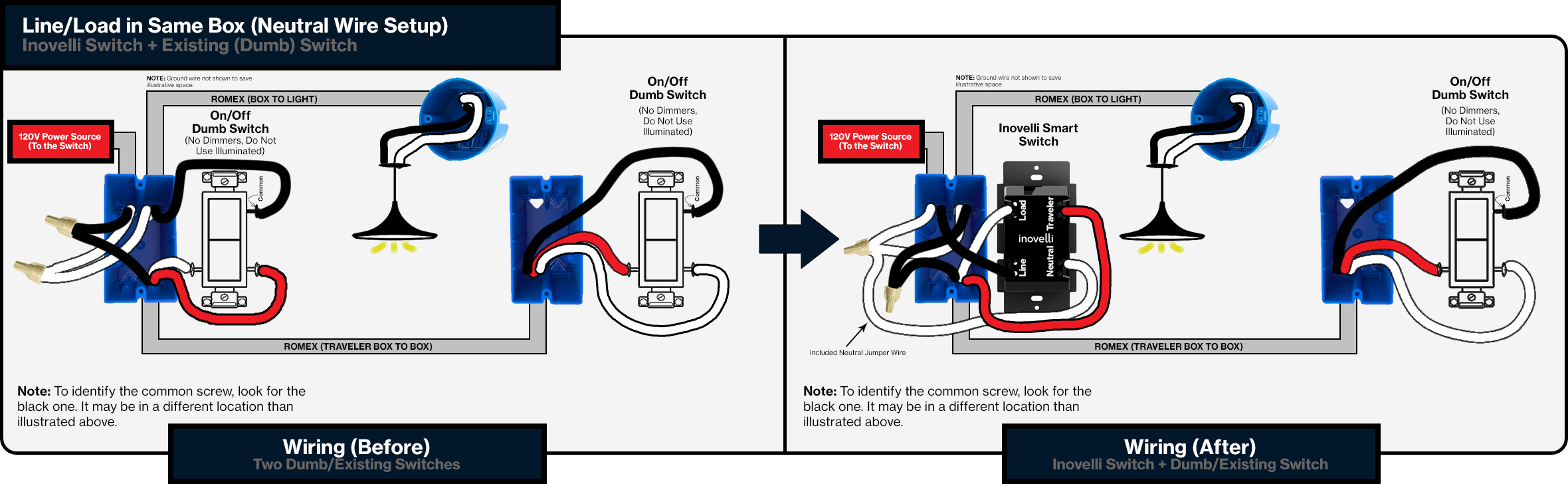

Any update? I just installed a new Red Dimmer today and it shuts off almost immediately after I turn off the Hue bulbs on the load line. I can hear the relay clicking. Note I am using a dumb switch 3-way scenario. Disable Local Control is enabled.
@ richthetech @ anon64478871 any ideas?
Hey @jeremykeen - when you mention the load side, are you talking at the dumb switch? Sorry, I’m a little confused here bc you mention the relay is clicking.
I just meant that the hue bulbs are the hard wired load on the switch. I followed the below wiring diagram. As I said, even with local and remote control disabled, when I power off the Hue bulbs via the Hue app, the lights turn off and then the red dimmer does as well. I can hear the click of the relay. I have a support ticket open as well.
https://desk.zoho.com/DocsDisplay?zgId=691830694&mode=inline&blockId=k4wwh08a2d8d608d24e718b6a6748c0d0b750
Are you sure you have a constant hot (line) to the box? I suppose it could be something weird with the switch, but it almost sounds like power is being cut to the switch because the Hue lights are off. It’s almost like the lights are somehow feeding the switch as in a non-neutral configuration. I wouldn’t think that would happen with a constant hot and neutral wired to the switch, but I suppose it’s possible.
I verified the wiring with a voltmeter. Line and neutral to the switch. Last night the switch remained on after I powered off the Hue lights but then today I looked and the switch is physically off again. To clarify, the switch has power and is operational but even though I have local and remote control disabled it is physically switching off the relay. This sounds a lot like the others in this thread.
I just discovered that my google assistant turned off the switch today. Will completely disable control both local and remote to see if this persists.
