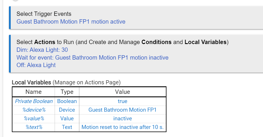

Here’s the latest rule I created for testing. btw, I don’t have any time how long the light stays on because the light will stay on as long as I am in the room even if I’m not moving.
Could your dim level be too low?
It’s not that. I set the minimum so it will turn on at 1%. 4 Led ceiling lights are super bright at 50% lol.
Understood. Some bulbs just won’t illuminate if it doesn’t reach a certain threshold. For example some of my bulbs would turn on unless I reached 40%, but the. I could lower it down to 20% no problem. However if I set for turning in at 30%, the bulbs wouldn’t illuminate.
I’d be curious if you could activate the rule then walk over to the switch and turn it up to see if bulbs turn on then.
I have some bulbs like that lol. My fix was to set the minimum. I keep on adjusting the minimum until the light turns on at 1%.
Unfortunately I tried turning up the switch. I also tried the the rule set at 80%. What’s odd is I can turn it on and off the light with the Hubitat console.
Does Hubitat have logging? See what happens when motion is triggered?
Have you confirmed that your sensor is detecting motion?
Maybe start with a simpler rule. Just turn the bulb on on motion. See what happens.
This is weird. I set the minimum to 80 and it worked. I set it back to 30 and it’s working normal again. Very strange. I only thing I can think of is when I added the switch back to Hubitat, I immediately set the minimum to 30. I probably should have left alone for 15min after adding it before making any changes?
