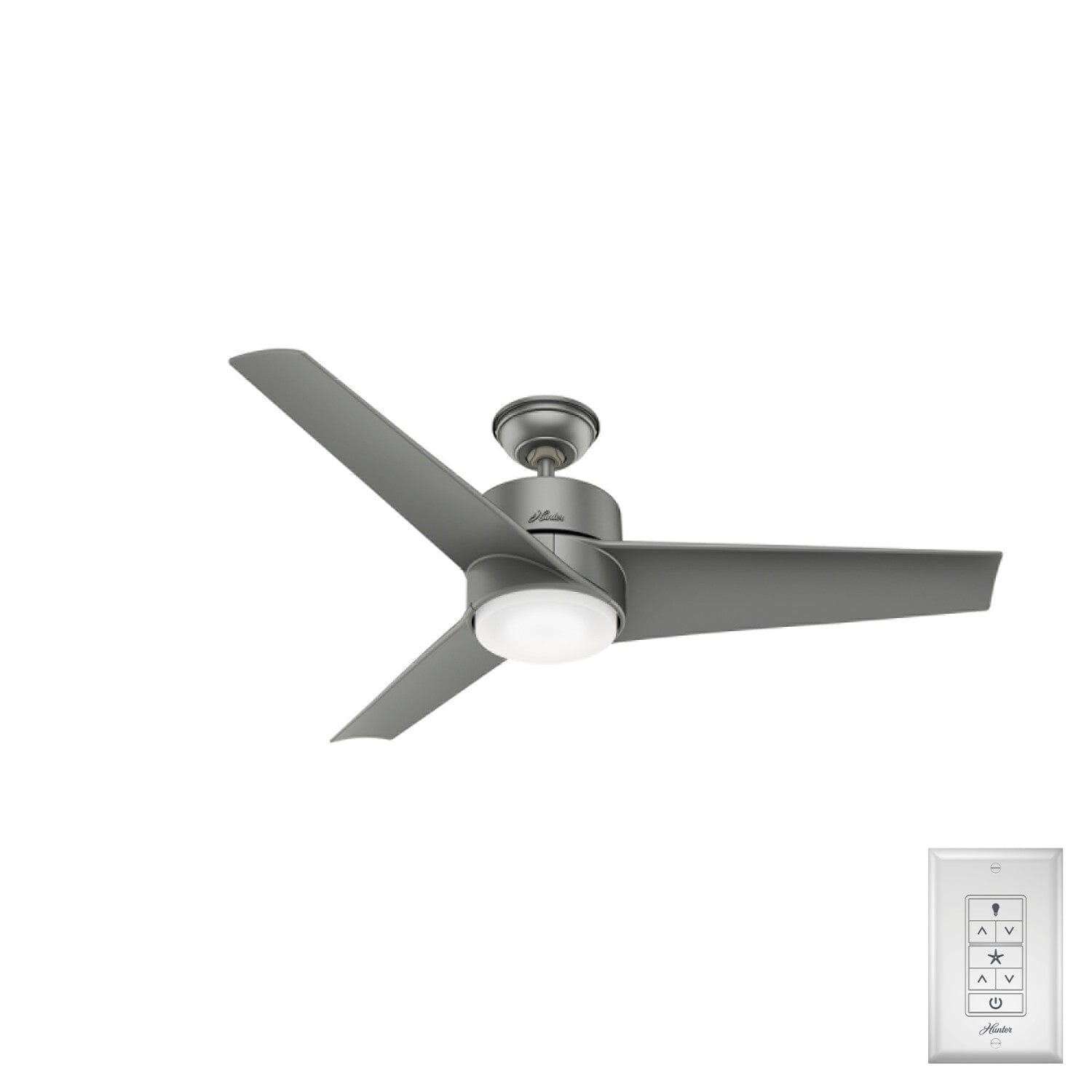

Try something like this:
It has a remote. But look on Page 6 of the manual- it talks about wiring a remote receiver in to the top of the fan.
That means if you take the included remote and receiver and set them aside, and instead use your Inovelli kit, you should be good to go.
You can also use any fan with a pull chain.
Thanks Chris. I see, so basically instead of using the receiver that comes with the fan I would use the innvollli canope receiver instead?
Thanks
Sal
Correct. If you can find a fan that has a kit like this then you’d replace their remote kit with Inovellis kit.
