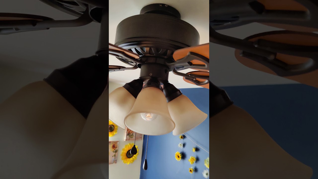

Edit: I just went back to my switch and wanted to make a quick video showing that the switch does work, I promise. I just wanted to see if there was any commonalities or differences amongst my setup vs yours.
You have your fan in winter mode! Need to reverse those blades baby!
Thanks for making that video. Appreciate your support as always.
