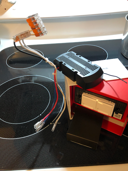

Since I am almost certain that the disconnect problem is in the switch and not the canopy module, I unboxed my second (of four) LZW36’s and dressed the wiring the same as the first one…only this time I took a picture to share:
DA57C696-8242-4315-BFA6-F77774C4EB4C
It will slide into the ball mount with the vents up (as pictured), with the wires facing upward (with Wago connectors on them) passing around the side of the bracket and up into the ceiling box and the wires facing downward (with the female blade connectors on them) hanging down into the canopy where there are shortened fan wires with male blade connectors waiting to connect the two.
