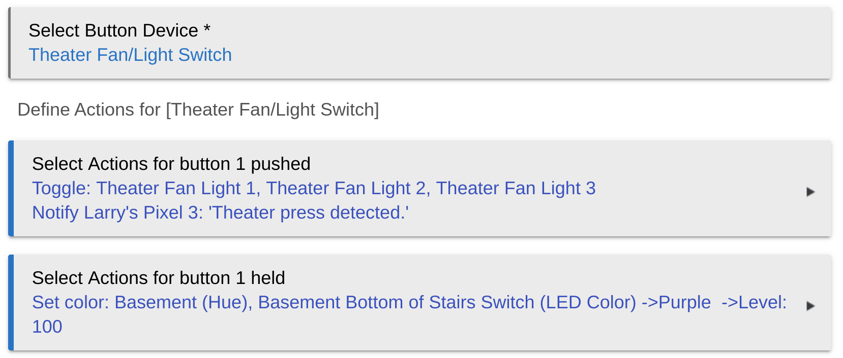

I am not sure if this is the same problem as @EricM_Inovelli is referencing above, but @Tomadock I believe you are likely describing the same problem as I am here:
Events are not being delivered from S2-enabled devices added in 2.2.3. Complicating the situation, there also seems to be an event delivery issue in Hubitat’s LZW36 driver, which also uses a button mapping that seems to differ from Inovelli’s driver.
A third person reported the problem as well:
@EricM_Inovelli can we please get some comment on this cluster of reports?

The hotfix (2.2.3.132) released today and appears to address the Hubitat side of the issue, but the Inovelli drivers are still not producing pushed/held events for at least some of the switches connected via S2.
More details here:
Posted this in the other thread, but in case you missed it:
ā€œThanks for the info. I’m not sure why the driver wasn’t working with button events on the C7, but I’ve fixed it so that it should.ā€
