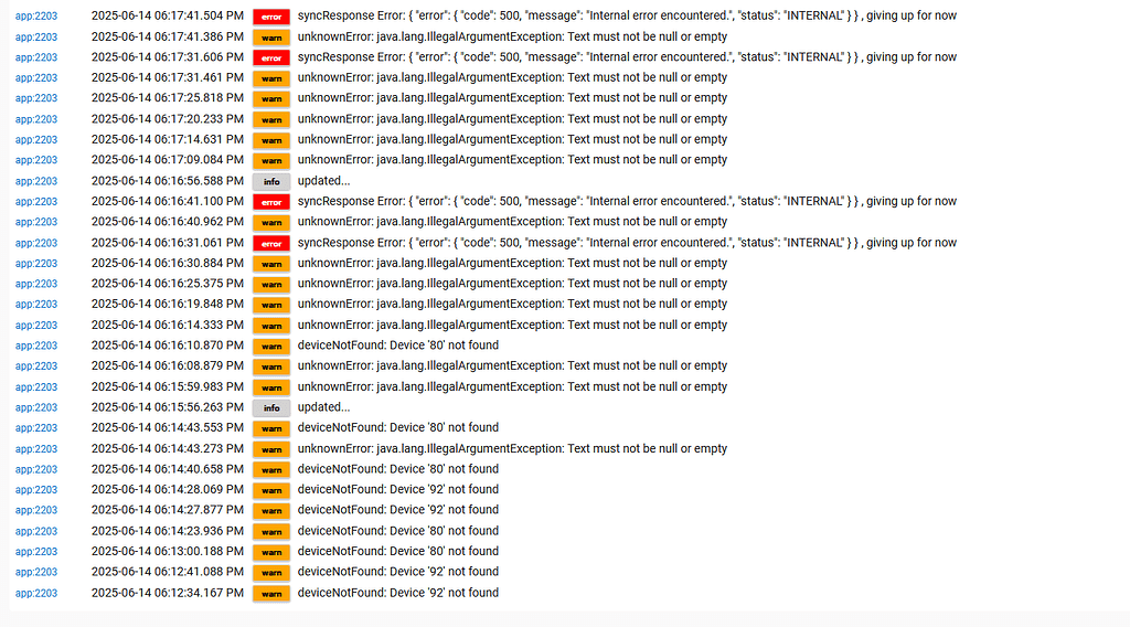

I was getting fatal errors with Google Home automation on my Hubitat–it appears that the issue relates to the fan drivers not supplying the required state values.
My LZW36 driver loads the “Hampton Fan Component” for the child device that controls the fan–and it is apparently missing required parameters. Some details are in the discussion on the Hubitat Community forum here:
Thoughts?

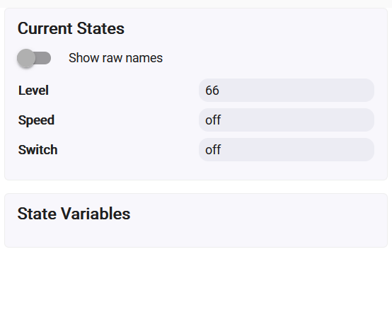

@robstitt Can you test this driver? Update the driver and then hit the configure button of the MAIN device. Let me know if you have any errors in your logs and let me know if the fan speeds show up on the child devices page.

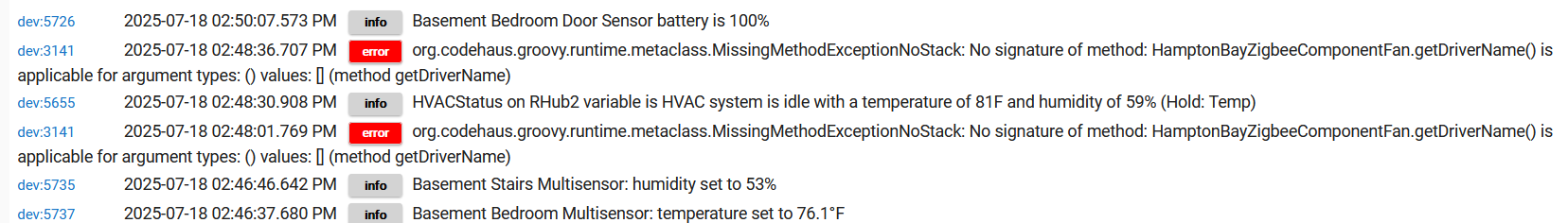

Didn’t seem to fix the child fan device.
Sorry about that, can you copy the driver from the link again and try again? I don’t have the device setup anymore in Hubitat so I am working on it a little blind. I corrected the error you are showing in the log.
I took “getDriverName” out of the driver. Are you sure you didn’t get a cached version or something? configure() should look like this:

Odd thing. That error is from the child device, not the parent.
It seems to be getting thrown by the system “Hampton Fan Component” driver?
I tried the generic fan component–same error.

W00t!! Seems to be working now!
Google Home is a bit wonky–but the device was added (and didn’t blow up Google Home any more). And, I can control it from Google Home also now!
