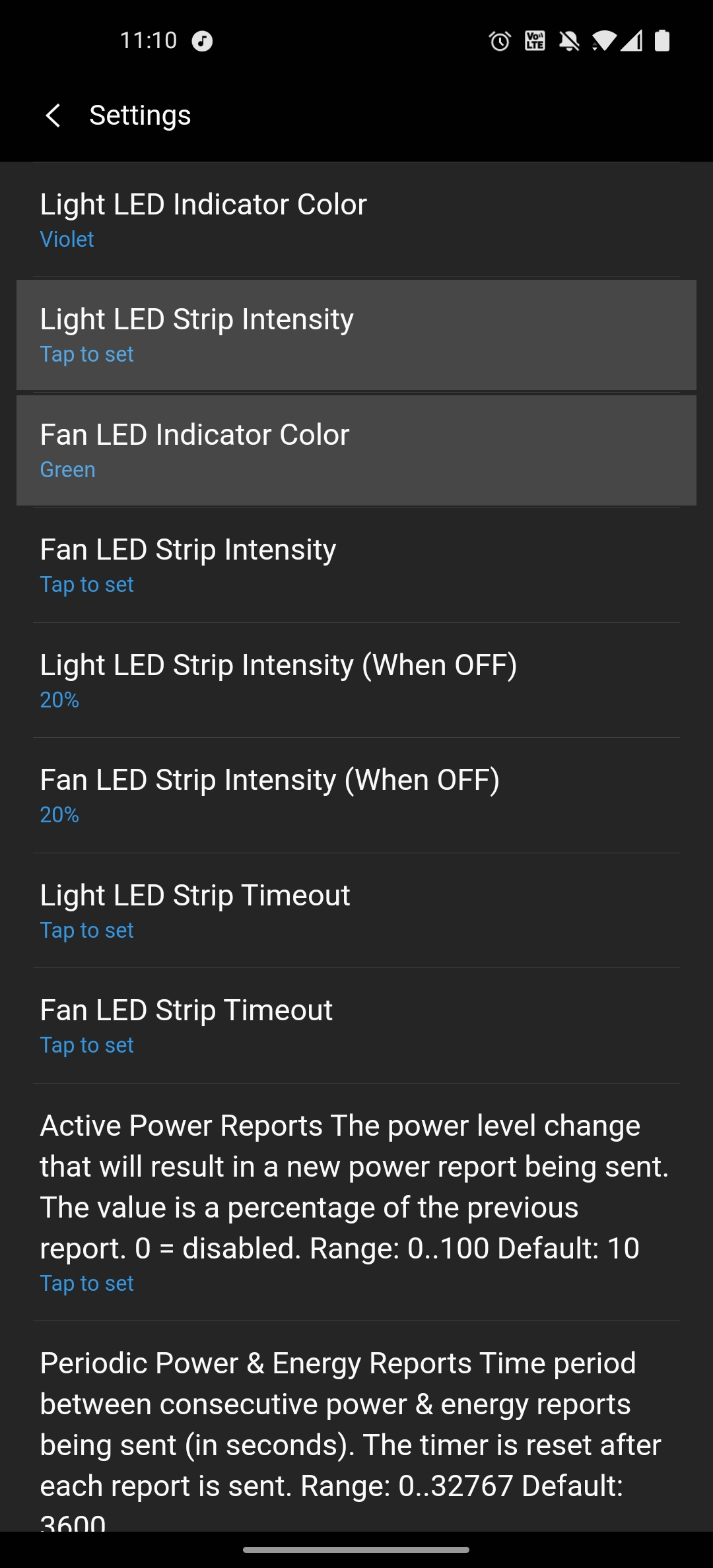

The colors can be changed from the ST app by clicking on the master switch and going into the settings:
I’ll have to check with @EricM_Inovelli on where this one is hidden!
