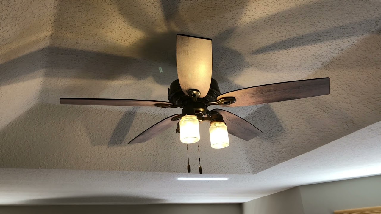

Brand new LZW36 (installed yesterday).
As soon as I turned it on I noticed the strobing effect.
The intensity of the “effect” is random.
When I first tested it today it worked just fine (first and second time), I was shocked. And then… the strobing started again.

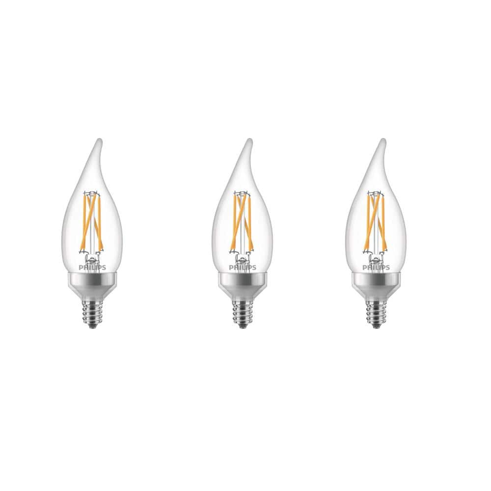

I thought it could be the ecosmart bulbs that came with the fan 4 years ago so I went out and bought these Philips Dimmable LED bulbs but it didn’t help.
In the first video you will notice one of the bulbs is different, it is the Philips one.
Same thing happens to it.
It it possible this is a defective unit?
Turning lights on:
Turning lights on and off:

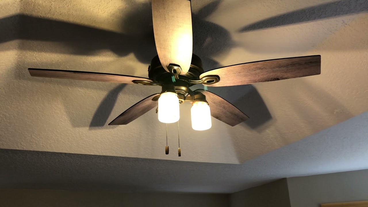

Meanwhile, here is another video so people don’t think I’m crazy when I said it worked yesterday when I first tested it.
It happened again today. The very first time I turned it on it worked and it is smooth so I’m guessing it is not the bulbs:
