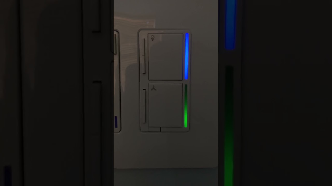

And then I created this rule:
One issue i think is that the levels are not 33, 66 and 100 as I’m setting so we have some flashing there. Another issue is the big delay until the color kicks so at the end it is really funky.
Would be cool if they had this built in tho.
What it looks like so far:
I’m guessing like you’re saying that maybe it doesn’t quite go all the way to the specific threshold before then being moved the rest of the way. If you use the low/medium/high speeds or voice commands to set to those speeds they will use 33/66/100 immediately, so kind of curious if you did that either via Hubitat directly or voice if that eliminates the problem…I’ll have a chance later tonight to maybe give that a shot myself if you don’t.
I tested it with voice command (Google) and didn’t make any difference.
I’m not sure how this translates to Hubitat, or if it even does, so this is FWIW.
The SetColor … hsl property is exposed. I can set it via webCore.
Hue and Saturation dictate the color, Level dictates the LED bar brightness.
Works on a Dimmer. I don’t have a 36.
I rewatched your video with the most recent rules after replicating it myself, and it looks like the brightness of the LED bar is just reflecting when you are increasing or decreasing the speed? It does take a second or two for the rule to trigger and process the color change but that’s about the same amount of time it takes the switch to react from the voice command as well so it’s about what I’d expect?
You are right, I think the delay is the biggest issue here. For whatever reason the switch takes forever to respond and waiting for it to change colors makes it even harder on the brain so I guess I will stick with a single color for now. Thanks all of your for helping.
